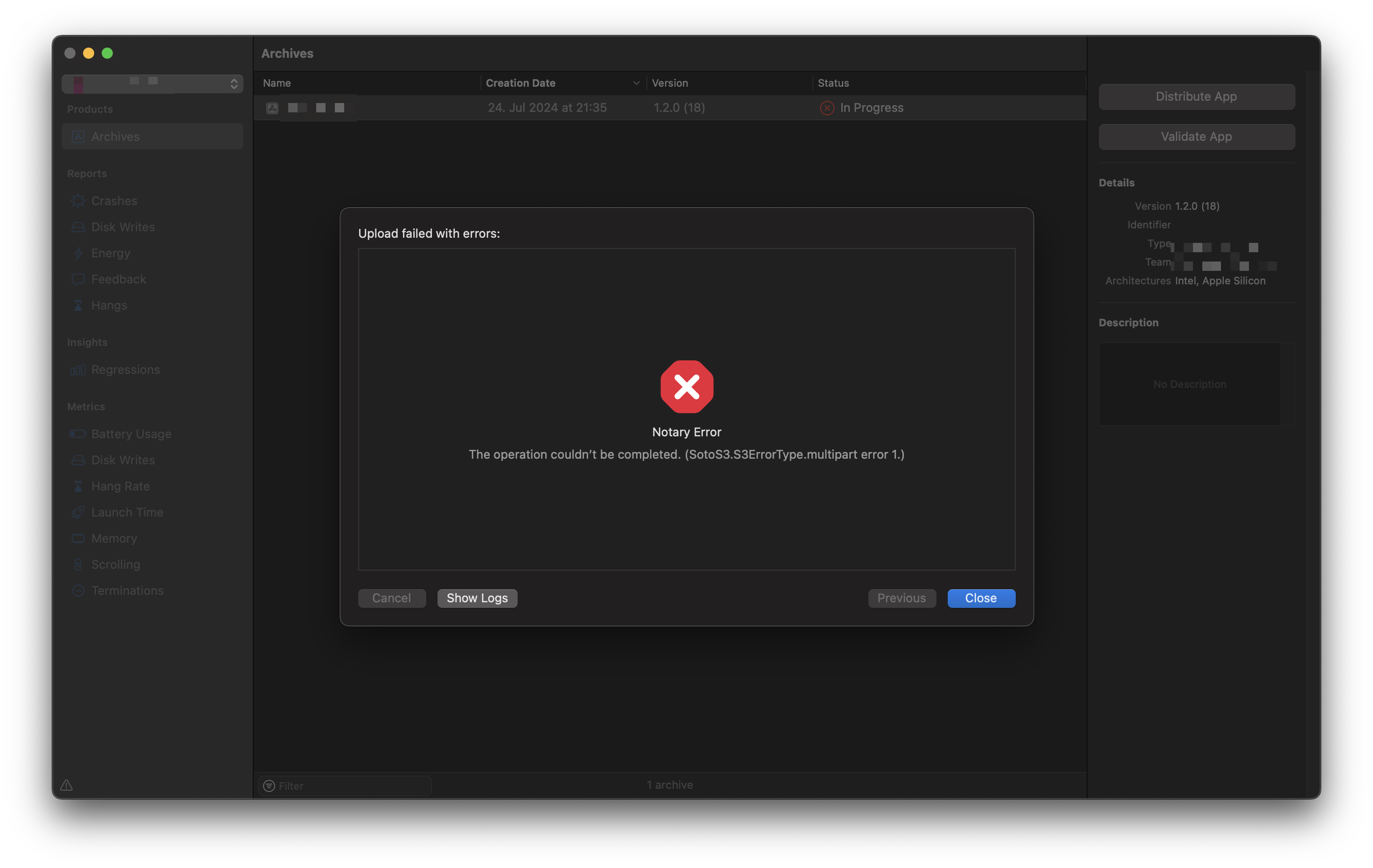

Notarization: The operation couldn't be completed. (SotoS3.S3ErrorType.multipart error 1.)
For my macOS app, on Xcode version 15.4 (15F31d)
on macOS 14.5 (23F79)
I follow Organizer > Distribute App > Direct Distribution, and I get a Notary Error "The operation couldn't be completed. (SotoS3.S3ErrorType.multipart error 1.)"
It's been happening since 3 days.

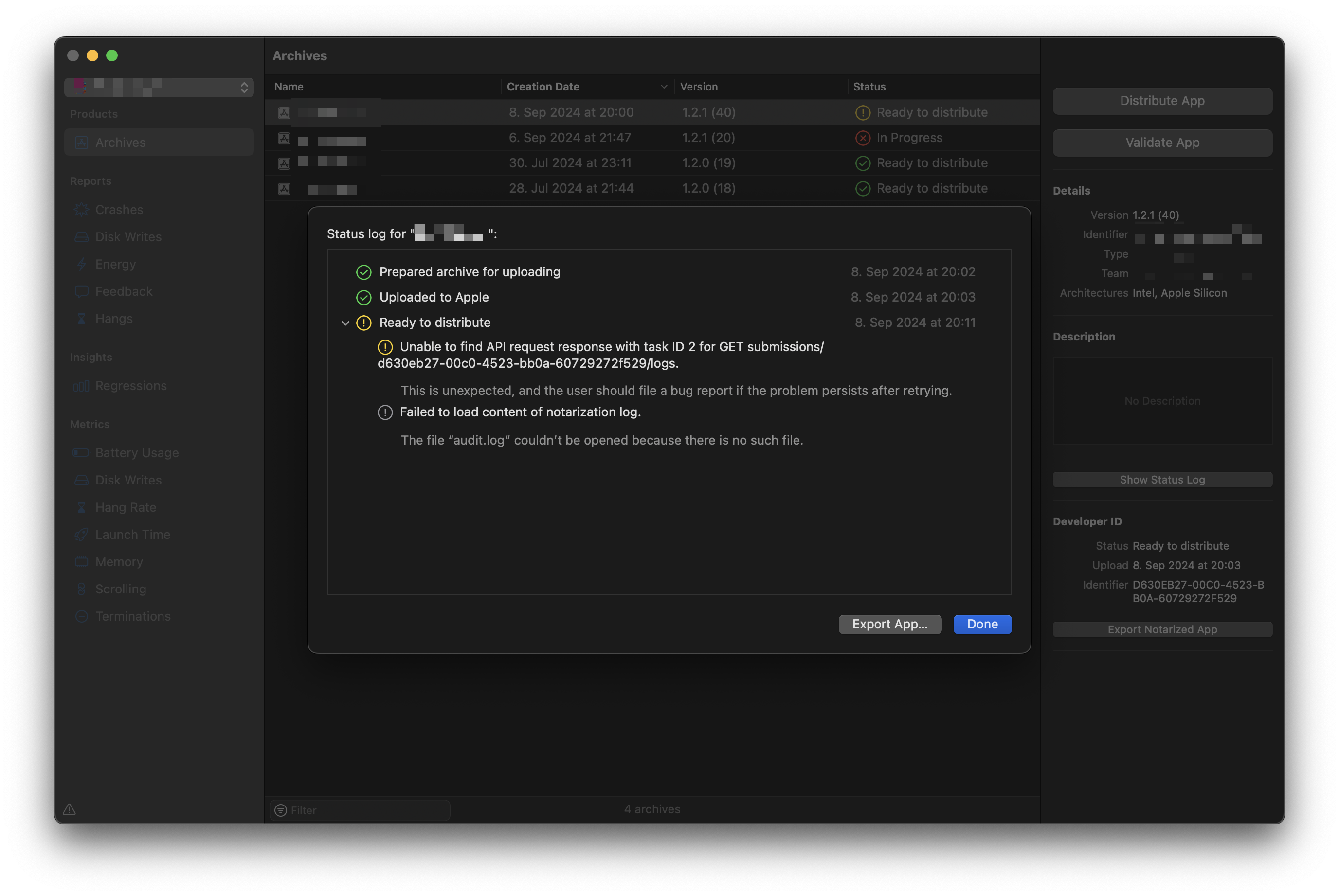

  • I turned off Private Relay (but this affects only Safari to my knowledge, right?),
  • connected to the Hotspot of my iPhone,
  • bumped the build number by 20 (to make sure not to use a build number that failed before).
This time upload was successful.
Notarization result was interesting though. It was notarized with a yellow exclamation point. When I looked at the status log, what I see is in the attachment.
Unable to find API request response with task ID 2 for GET submissions/ d630eb27-00c0-4523-bb0a-60729272f529/logs.
Not quite. Quoting Prepare your network or web server for iCloud Private Relay:
Private Relay protects users’ web browsing in Safari, DNS resolution queries, and insecure http app traffic.
Cool.
When I looked at the status log, what I see is … Unable to find API request response with task ID
Yeah, that’s a weird one. I’ve seen this before (r. 129397668). It’s not at all clear what’s causing it.
The other folks I’ve seen with this problem don’t see it all the time. It seems to come and go. So retrying may allow you to notarise properly.
Beyond that, you can check the notary log from the command line, as discussed in Fetching the Notary Log.
