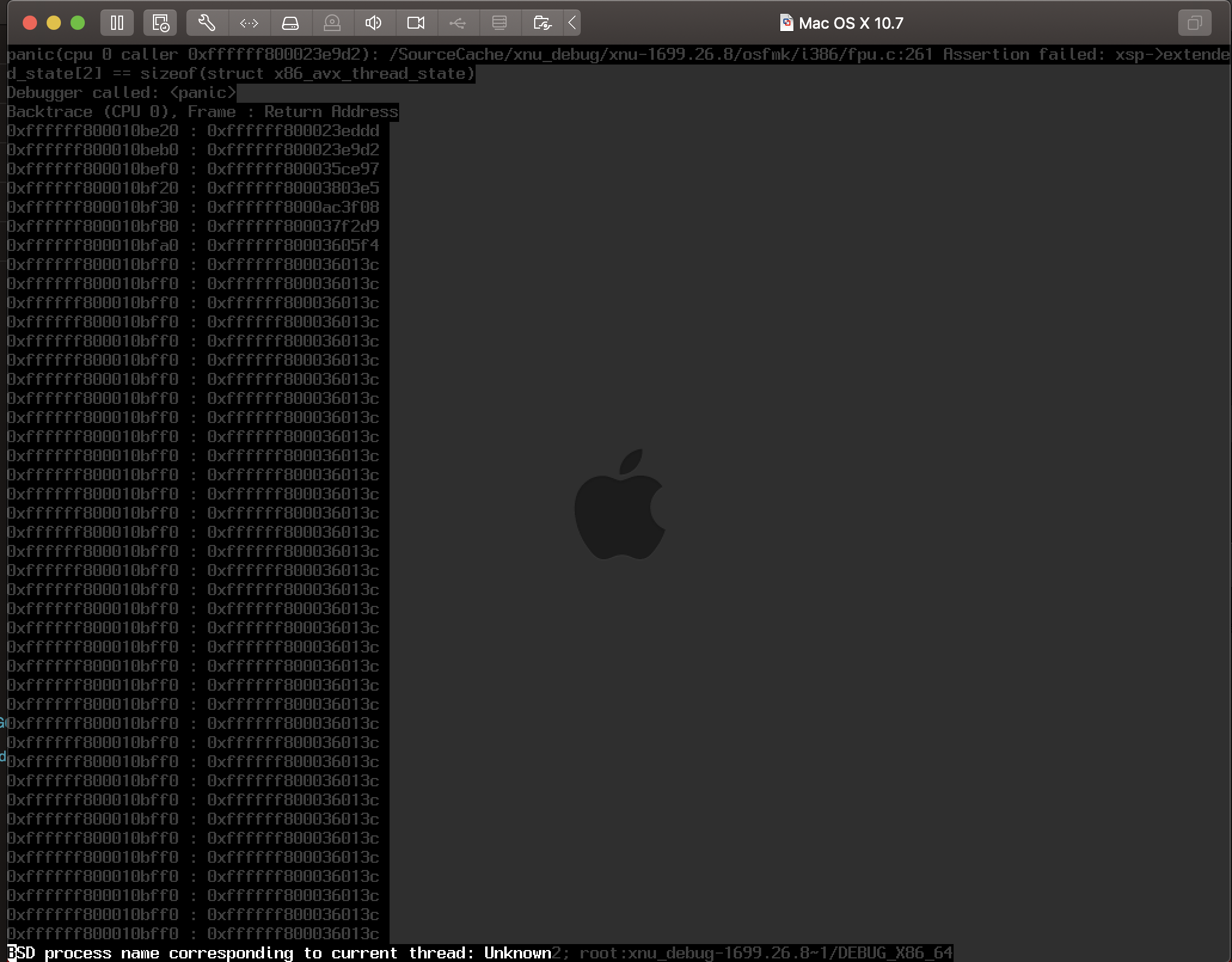

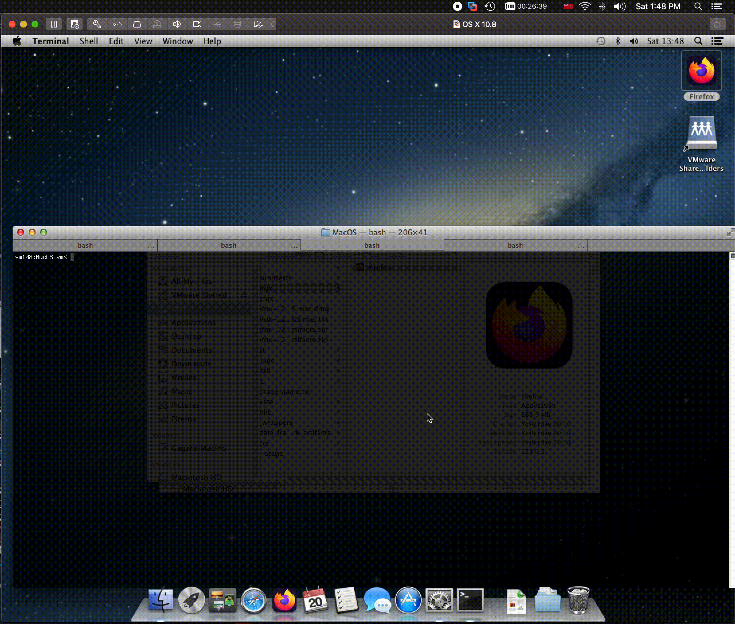

i'm trying to get firefox running in 10.7 but the kernel is crashing. i have it working/running/looking great on 10.8 and higher.
something is happening in 10.7 that is causing the panic. i need the right kit.

right now using either the 10.7.0 or 10.7.4 kernel debug kit causes a panic on reboot; something to do with AVX and the fpu. i am hoping APPUL had enough foresight to see this would be an issue (even one year later) for people on newer architectures debugging for older, supported (until 2014) targets:
this use-case definitely falls within the parameters.
