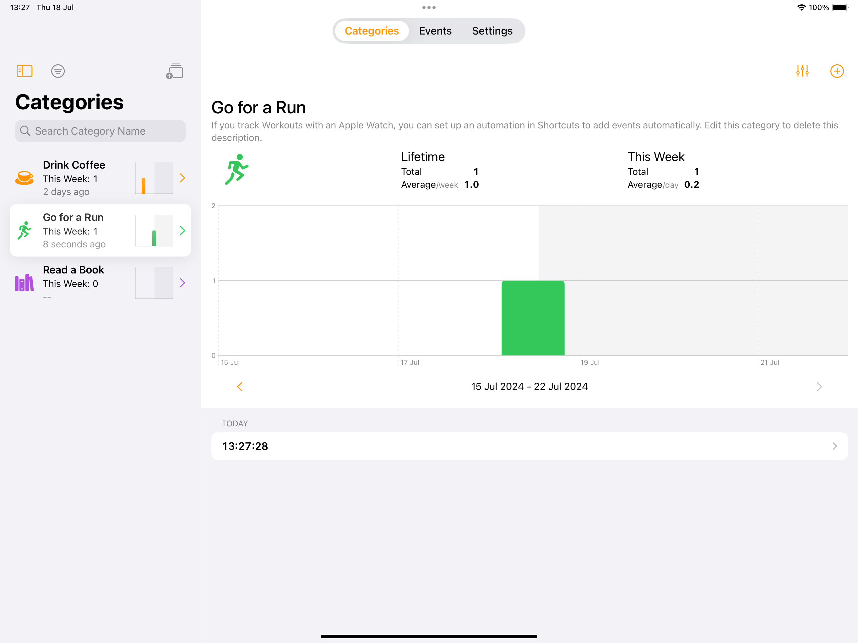

I've used a NavigationSplitView within one of the tabs of my app since iOS 16, but with the new styling in iOS 18 the toolbar region looks odd. In other tabs using e.g. simple stacks, the toolbar buttons are horizontally in line with the new tab picker, but with NavigationSplitView, the toolbar leaves a lot of empty space at the top (see below). Is there anything I can do to adjust this, or alternatively, continue to use the old style?

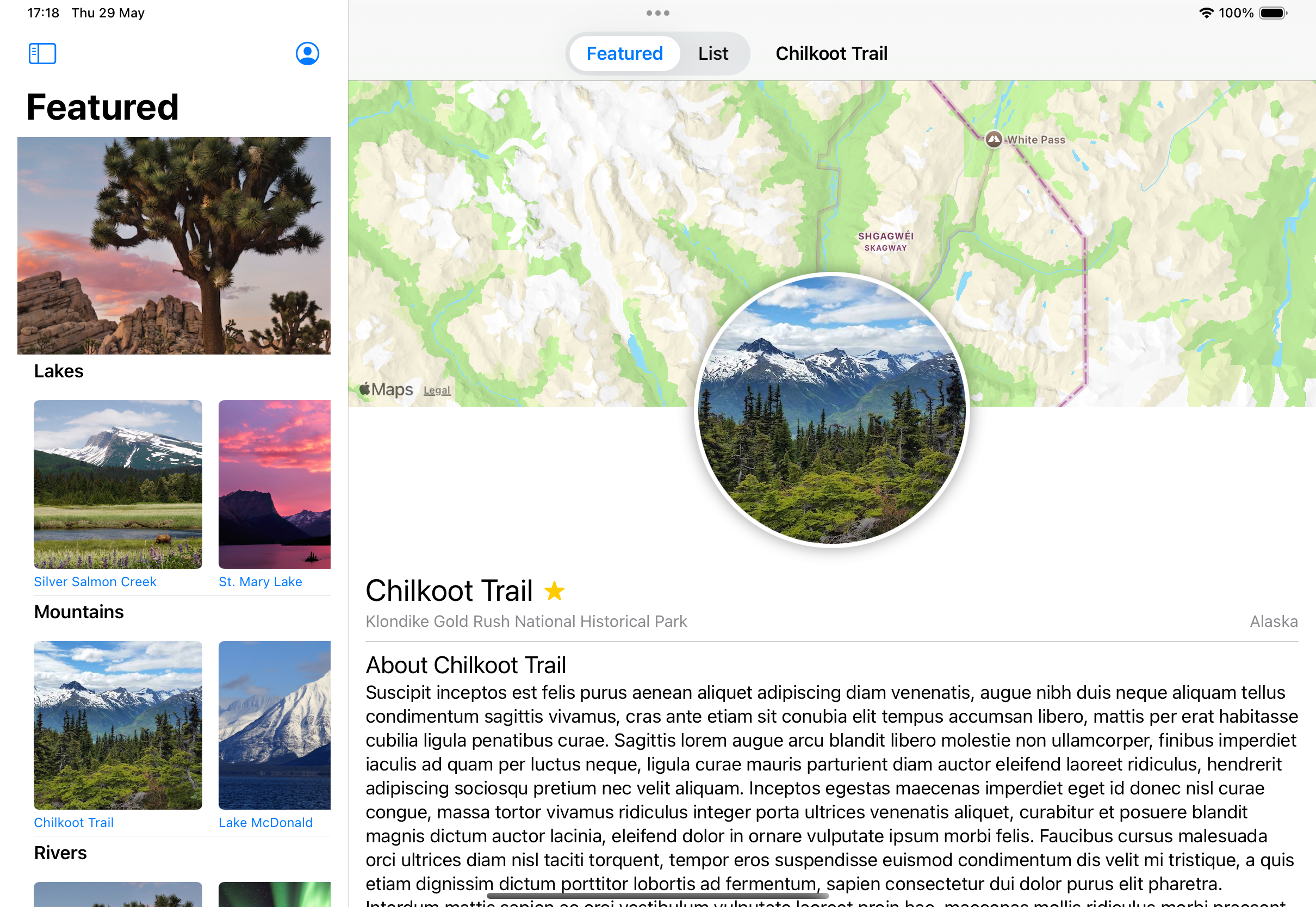

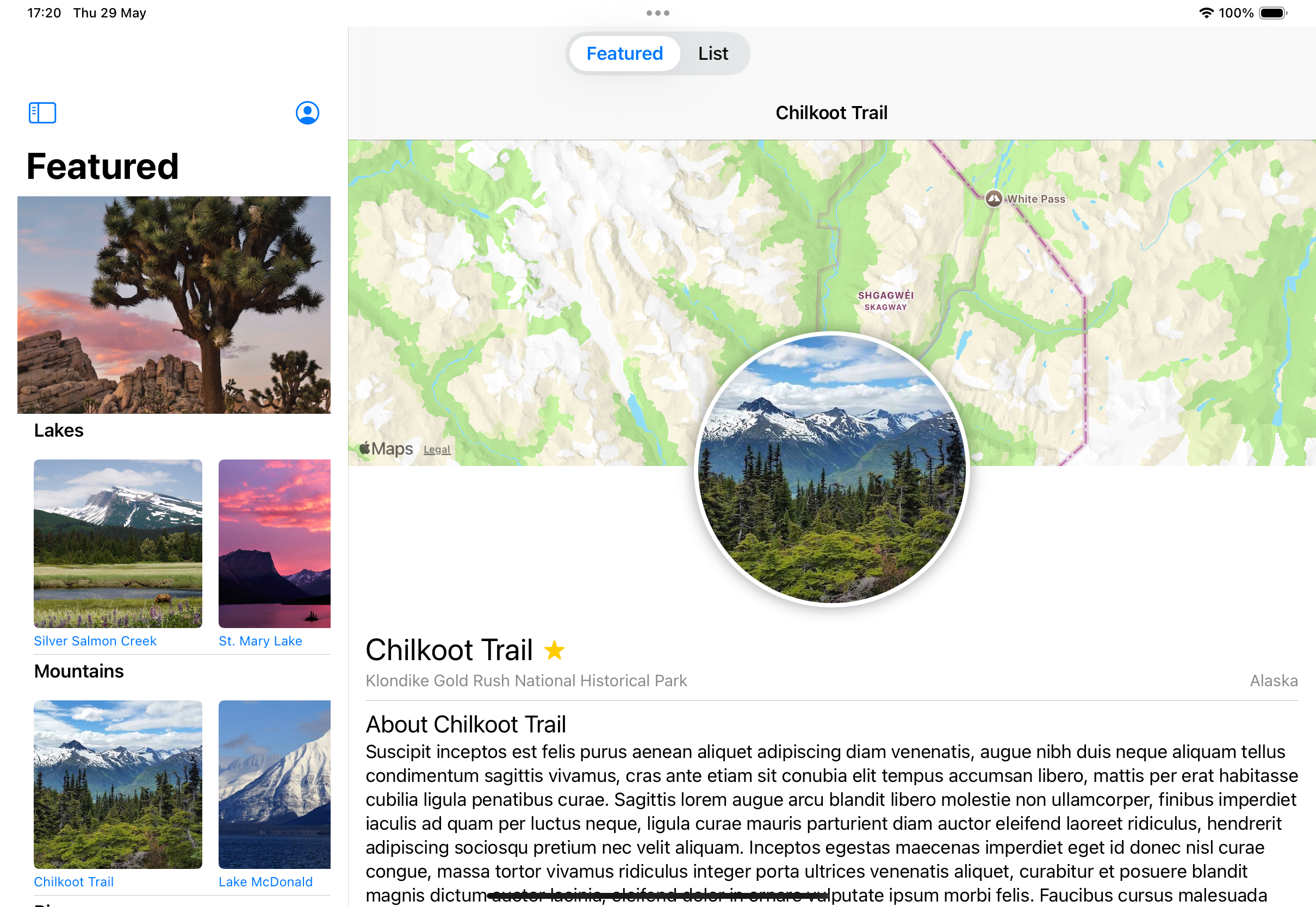

This is still happening in the release version of 18.5. If you want to easily see the issue then run Apple's own Landmarks tutorial on iPad OS and compare how it looks on the 18.2 simulator compared to the 18.5 simulator.
Here are screenshots of each...
