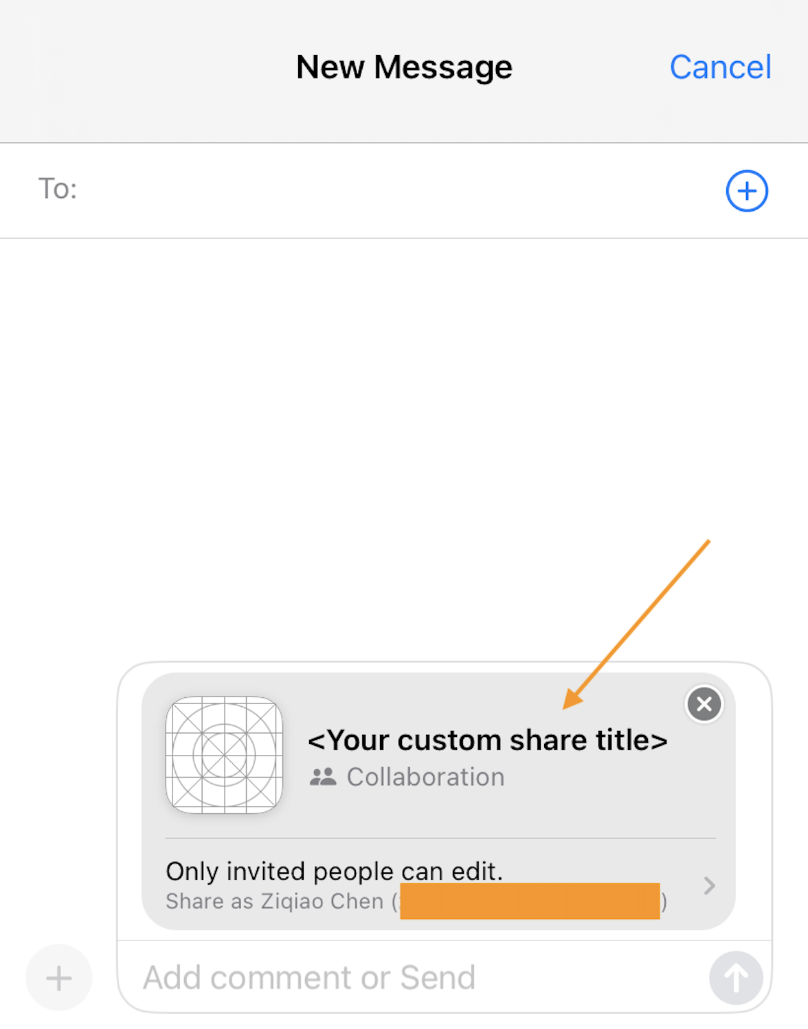

The preview of a share (CKShare) shown in iMessage does display the value of CKShare.SystemFieldKey.title for me. I confirmed that by using the Sharing Core Data objects between iCloud users sample in the following way:

c. Build and run the app, and try to add a new photo and share it again.
At step c, I see that the value of share[CKShare.SystemFieldKey.title] is on the preview, as shown in the attached screenshot.
You might try the same flow to check if you see the same result.
