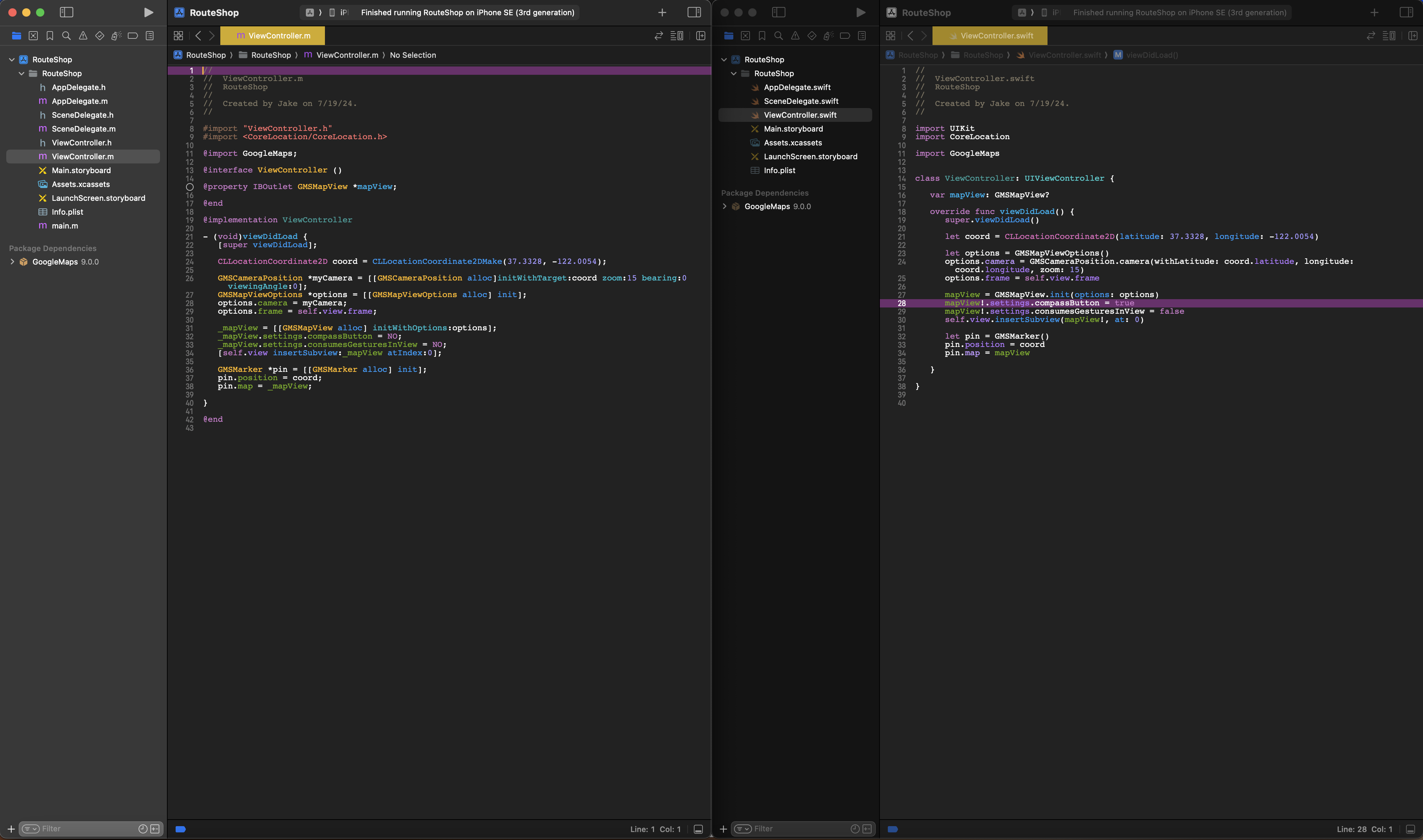

I now have 2 stripped down versions - one ObjC and one Swift. They produce the same results. I have attached a screen-cap herein that shows the 'theme' discrepancy. The left side being the Objc version shows the proper theme colors, the right side being Swift does not. Note that any terms using "GMS" show the discrepancy of concern.

Thank you for your help. The files (zipped) are now uploaded to the Feedback Assistant. Here's the URL for the issue: https://feedbackassistant.apple.com/feedback/14399508 This my first time doing such, so please let me know if I have done this correctly.
