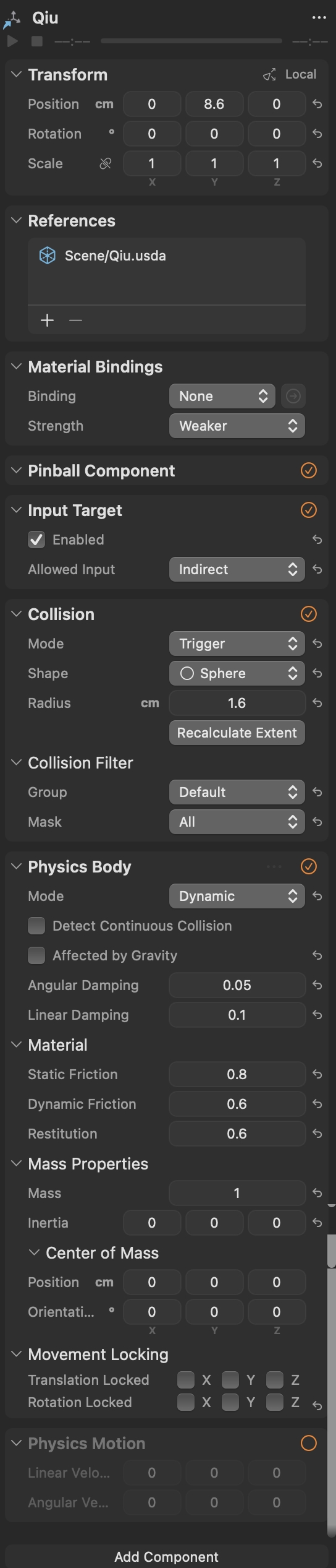

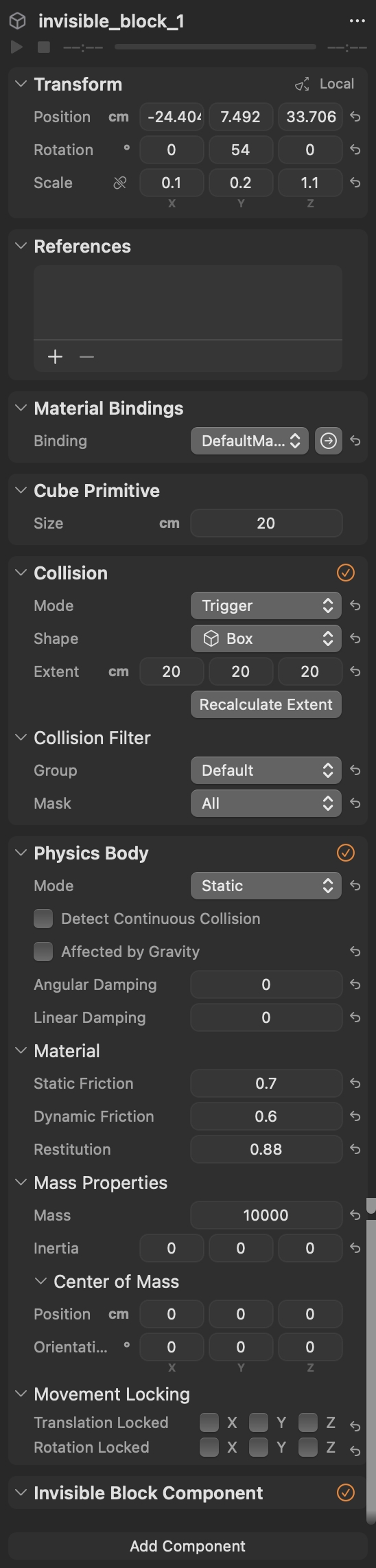

@Vision Pro Engineer Thanks for your reply and your help! I just copy and paste all of the parameters in your code snippet. But this still not works. I didn't paste the code because most of the component's parameters are set in Reality Composer Pro. You can see that in my attachments.
I am thinking it's about ModelEntity. In my case, "Qiu" is a ball with sphere collision box, but I checked that in my code, Qiu cannot be cast into a ModelEntity. I am thinking probably the Entity itself doesn't have a mesh attached to it, because Qiu is imported from a DCC, it has a child Entity containing a meshResource (but no collision sphere attached to this Entity).
But as the document said, as long as an Entity has PhysicsBodyComponent and a CollisionComponent, it should have the ability to participate physics simulation. Or there must be some misalignment between RealityComposerPro and RealityKit
I’m not an expert in Realty Composer Pro so I only have standard troubleshooting advice to offer. Let’s narrow down the cause of the issue. Replace “Qiu” with a primitive sphere; that will help us determine if the issue is specific to your model. Let me know if that doesn’t reveal something that helps you resolve the issue and I’ll see if I can get someone from the Reality Composer Pro team to help next week.
I just tried to reproduce this with a primitive box and sphere and noticed Qui's Physics Body is not "Affected by Gravity". It needs to be; after I checked "Affected by Gravity" the sphere bounces as expected. Please check the checkbox and let me know if that resolves the issue.
