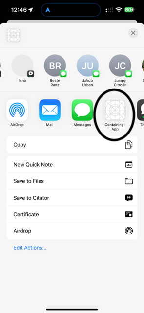

I want to share a Transferable (JSON-encoded) data struct from some HostApp with an Extension of my ContainingApp, and get a different Transferable (also JSON-encoded) data struct back on success.
Since I want to present my ContainingApp's AppIcon in the sharing sheet to make it easy for the user to find it, I started building a Sharing Extension and not an Action Extension. AFAIK the difference is only in the presentation (Sharing Extension: Icon+name of the ContainingApp vs Action Extension: simple b/w system icon plus a string describing the action (e.g. "Copy", "Save to Files")), and the data flow is identical. Please correct me if I'm wrong.
I added the Sharing Extension to my ContainingApp (which are both in the same app group so they can use a shared container to exchange data). The (real) HostApp is from a different company we are collaborating with, and thus is not in our app group. Once everything runs I will add a tailored NSExtensionActivationRule to make sure our Sharing Extension is only shown to our partner's HostApp. Currently I am still using TRUEPREDICATE. The goal is that after the user tapped the "Continue with ContainingApp" (Share-)button in the HostApp, iOS will only show my ContainingApp icon and nothing else, since that's the only useful choice for the user.

After the user tapped on the ContainingApp icon in the sharing dialog, my Sharing Extension will show its dialog, presenting the shared item it got from the HostApp, and let the user edit the text.
When the user taps the "Save"-button in my extension, it creates a ShareResult struct to send back to the HostApp, and dismisses the sheet.

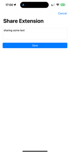

This (kinda) works when I share plain text with the 􀈂Text button in my HostApp. My ContainingApp icon is shown together with Mail, Messages, and other apps that can process plain text; with shortcuts to persons and devices (AirDrop targets) in the line above, and with actions (Copy, New Quick Note, Save to Files, Save to Citator, Certificat, Airdrop) below.
When I choose my ContainingApp, the extension runs and shows the text it got. ("Kinda" because I am still struggling to send data back. See below...) So the principal operation works...

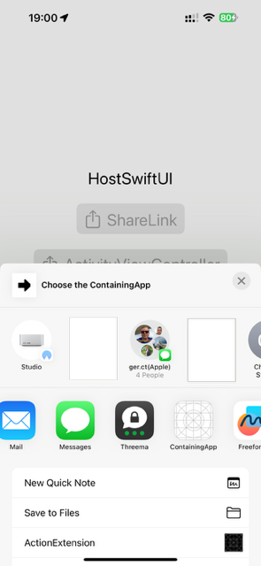

I implemented the ShareLink() anyway (and ignore the result part for the moment).
When I try to share a ShareInput struct with the 􀈂ShareLink button, the same persons are sorted differently, there are less app icons (9 instead of 13), and less actions (only 3: New Quick Note, Save to Files, AirDrop): Note that while the preview correctly shows the preview text provided ("shareInput"), the preview image left of it is blank (instead of arrowshape.right.fill):
	        let preview = SharePreview("shareInput", image: Image(systemName: "arrowshape.right.fill"))
When I choose my ContainingApp, the extension runs ...

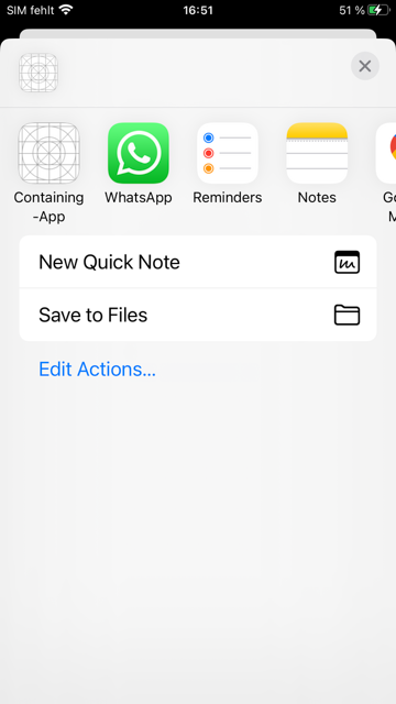

However, on iOS 16 it doesn't work:
	Host[8615:634470] [Type Declaration Issues] Type "com.myapp.shareInput" was expected to be exported in the Info.plist of Host.app, but it was imported instead.
	Host[8615:634462] [ShareSheet] Couldn't load file URL for Collaboration Item Provider:<NSItemProvider: 0x280f49180> {types = (

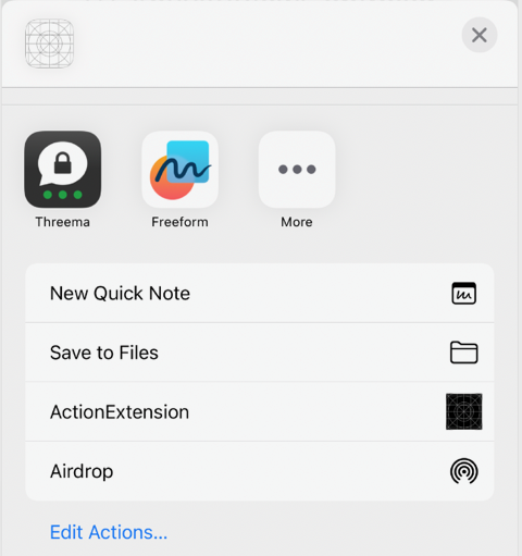

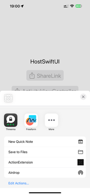

When I try to share a ShareInput struct with the 􀈂JSON button (using present(activityViewController)), I see (both on iOS 16 and iOS 17):
My extension (rather, the ContainingApp's icon) is not shown as Sharing target (even though it still has TRUEPREDICATE), which means that my code didn't manage to pack the ShareInput struct for the activityViewController - and thus it doesn't know what to share.
I did the same as with the plainText item before:

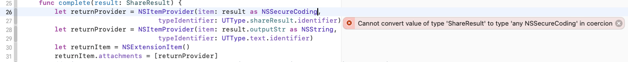

For the result, I didn't manage to pass a ShareResult struct to NSItemProvider:
I just found
        NSItemProvider(item: contactData as NSSecureCoding, typeIdentifier: UTType.vCard.identifier)
which probably works because contactData is known to iOS...

With ShareLink, I can specify a SharePreview:
  let previewTitle = "Choose the ContainingApp"
  let image = UIImage(systemName: "arrowshape.right.fill")
  let preview = SharePreview(previewTitle, image: Image(uiImage: image!))
  ShareLink("ShareLink", item: shareInput, preview: preview)
and get this:
but since ShareLink cannot receive data sent back from the extension, I need to use a UIActivityViewController with completionWithItemsHandler:
  let itemSource = InputItemSource(shareInput: shareInput, previewTitle: previewTitle, previewImage: image!)
  let configuration = UIActivityItemsConfiguration(objects: [itemSource])
  ActivityViewController(configuration: configuration)
      .presentationDetents([.medium])
As you can see, there’s no preview image and text:
