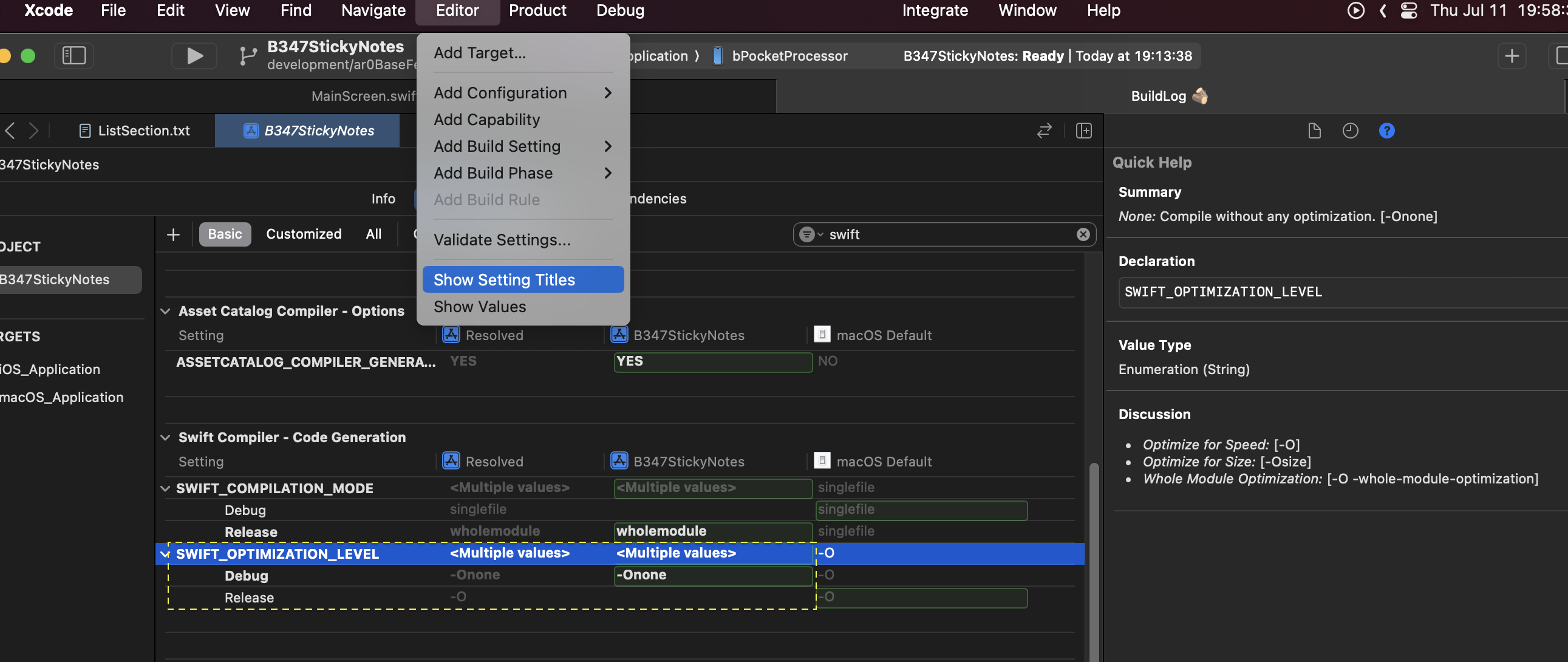

hi. I think you should provide more log data from the failing build process.
did you made changes in build settings about compiler optimization flags/settings? maybe overwritten by mistake some values? compare with other easypeasy sample project…any difference in build settings? same result?
check build setting: SWIFT_OPTIMIZATION_LEVEL
-Onone is to my knowledge more or less the default setting. so if missing, just create/modify the entry in the project build settings.

@B347 thank you so much :)
