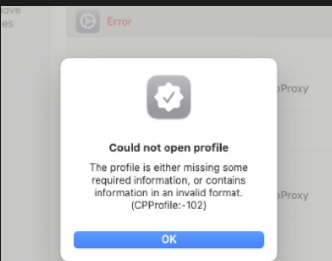

Thanks for the reply.
We have tried the suggestion but are still seeing the error. Attached are the config file (please remove the .txt format after downloading the config) and the screenshot.
While that message isn’t super helpful, my experience is that the configuration profile ingest mechanism is pretty good about logging useful diagnostics when it encounters an error. I recommend that you look in the system log for more info.
For hints and tips on how to use the system log effectively, see Your Friend the System Log.
