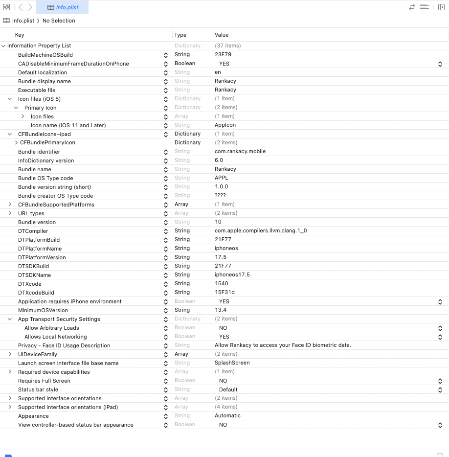

Hi Eskimo,
I am sorry for late reply
As you mentioned I've exported the build and l've looked inside the Info.plist
So you can see the ATS is enabled, maybe the local network is the issue in production build?
Our BE service is compliant based on the first logs I gave you so it's quite confusing that default settings are not correct.
I've also tried the check/test tool in Xcode and it was fine, no issues found
