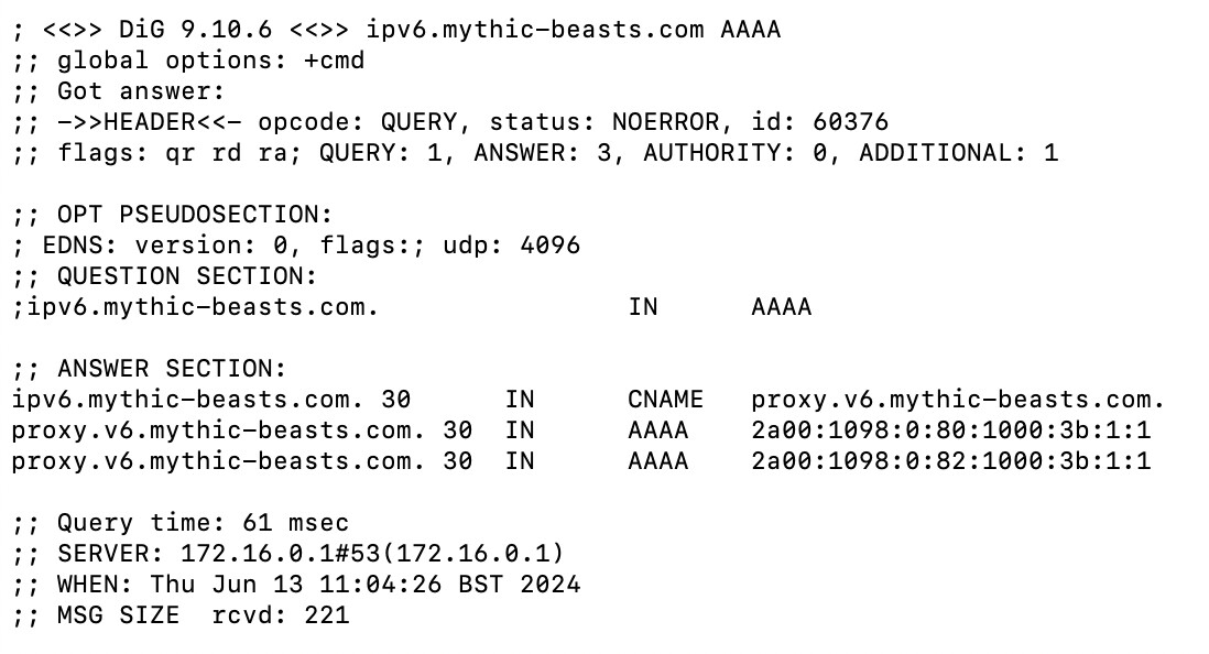

ipv6.mythic-beasts.com for the purposes of this is just a test website I am using that only has a AAAA record associated with it:
When not connected to the Packet Tunnel Provider, the website is successfully resolved and can be viewed within the browser - so I have narrowed it down to either the server or tunnel configuration.
