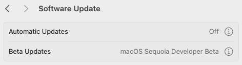

Correction: In order for the softwareupdate tool to find the Sequoia beta, you must have the Sequoia beta update channel turned on:
