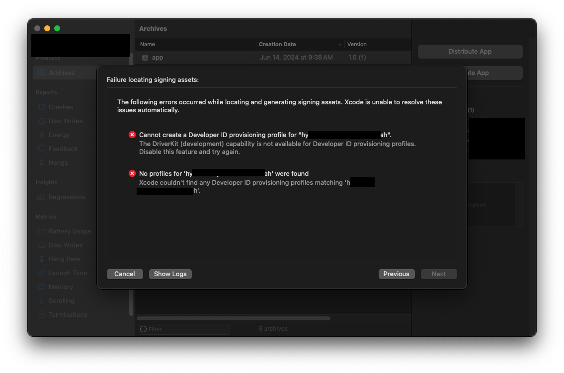

I developed an app including driver extension. So I tried to distribute it to users. Of course, it works fine in my Mac. I pressed "direct distribution" through the distribution menu in xcode, but the error occurred as below. I also checked that distribution are fine with TestFlight(internally), checked unregistered mac device. I can't figure out what's wrong, so I'm asking for help.

The most common cause of problems like this is that you’ve not been granted access to the DriverKit capabilities for that distribution channel for that platform. Check these using the process described in Finding a Capability’s Distribution Restrictions.

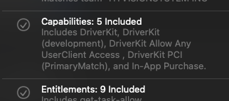

thank you for your reply.. I try remove the "DriverKit (developer)" and keep the "DriverKit" (on additional capabilities), but on my driverkit profile, "DriverKit developer" has not disappear.
How to remove the "DriverKit developer" on Capabilities?
