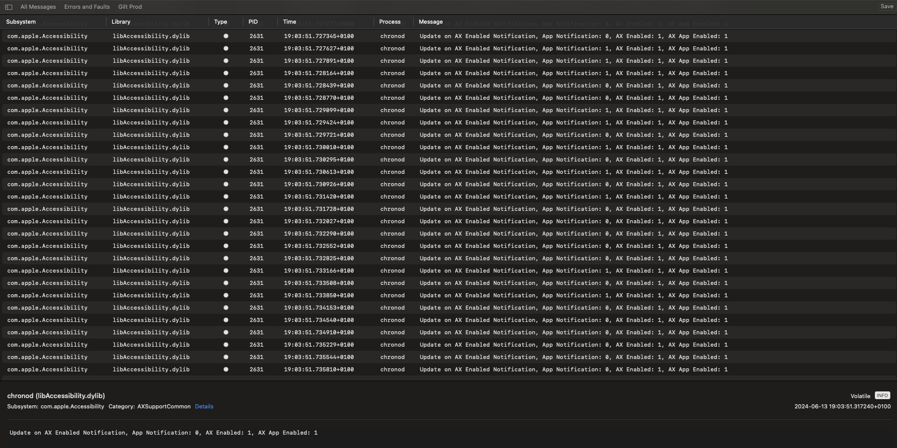

I installed Xcode 16 beta on Sonoma 14.5 and tried to run my app on the simulator, but it's practically impossible to use. It's extremely slow and unresponsive.
After doing some research, I noticed that launching any application causes the simulator to flood the system with logs. This triggers the diagnosticd process, which increases memory and CPU usage, worsening over time. The memory usage peaked at 10GB before I decided to close the simulator.
Has anyone else experienced this issue? Is there any solution for this?

Yes, it's a corporate machine running CrowdStrike, which is also showing high memory and CPU usage during the process. This coincides with the diagnosticd process, likely due to the large amount of logs being generated when running the simulator or the SwiftUI preview.
