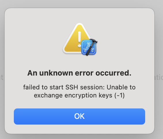

Since my first message, the problem were fixed but yesterday (26 november) it starts again to send a different error:
Any idea how to fix this?
