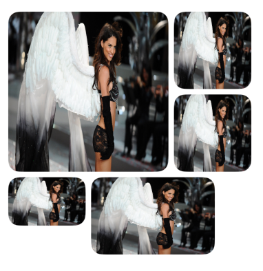

I've defined a custom layout container by having a struct conform to Layout and implementing the appropriate methods, and it works as expected.
The problem comes when trying to display Image, as they are shown squished when just using the .resizable() view modifier, not filling the container when using .scaledToFit() or extending outside of the expected bounds when using .scaledToFill().
I understand that this is the intended behaviour of these modifiers, but I would like to replicate UIImageView's scaledAspectFill.

But hardcoding the frame like that defeats the purpose of using the Layout, plus I wouldn't have direct access to the correct sizes, either.
The only way I've managed to make it work is by having a GeometryReader per image, so that the expected frame size is known and can bet set, but this is cumbersome and not really reusable.

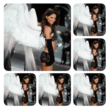

@DTS Engineer – Thanks for the response. I had considered those options but weren't ideal.
I found a slightly better approach, though.
As the expected behaviour is to fill all the available space with the image, we can just use Color (which, when used as a view, expands to fill all the space it is given) and the Image as an overlay.
This will effectively make the Image expand to use all the available space whilst clipping it to its bounds.
Color.clear
.overlay {
Image("adriana-wide")
.resizable()
.scaledToFill()
Not quite the solution I was expecting, but does the trick.
