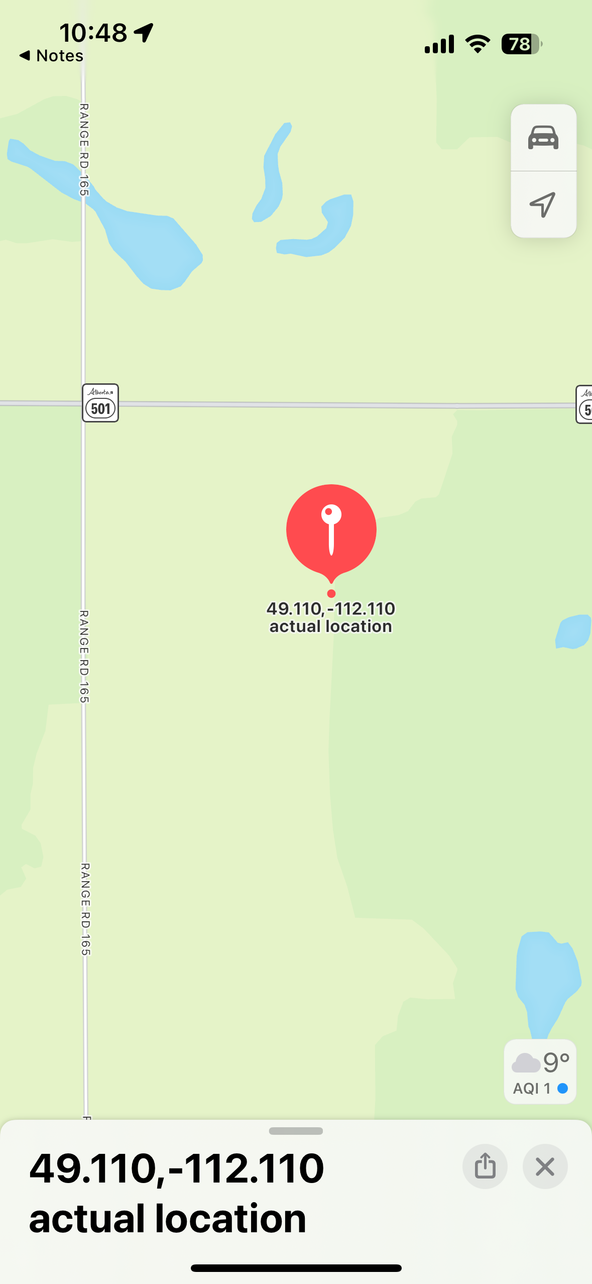

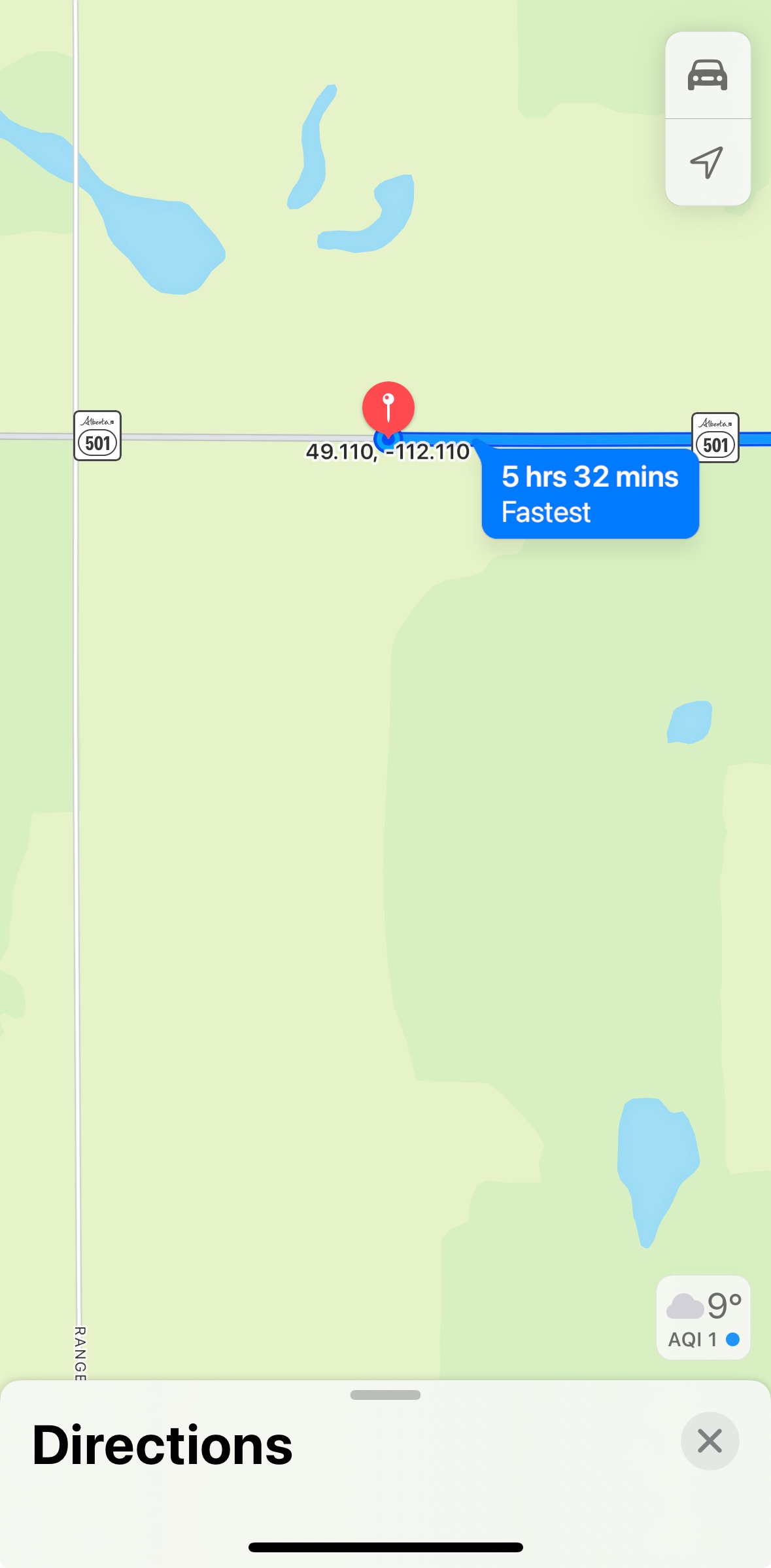

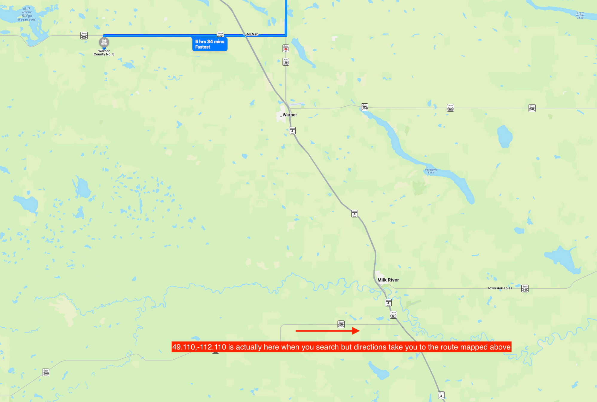

In Apple Maps (iOS or macOS), if you search a latitude and longitude -- for example: "49.110,-112.110" and search, it centers on the location as it always has and shows the "Directions" button. When you tap the directions button, I get "A route can't be shown because of a problem connecting to the server.".

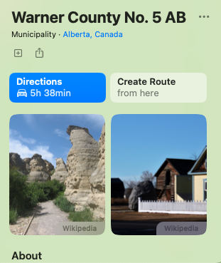

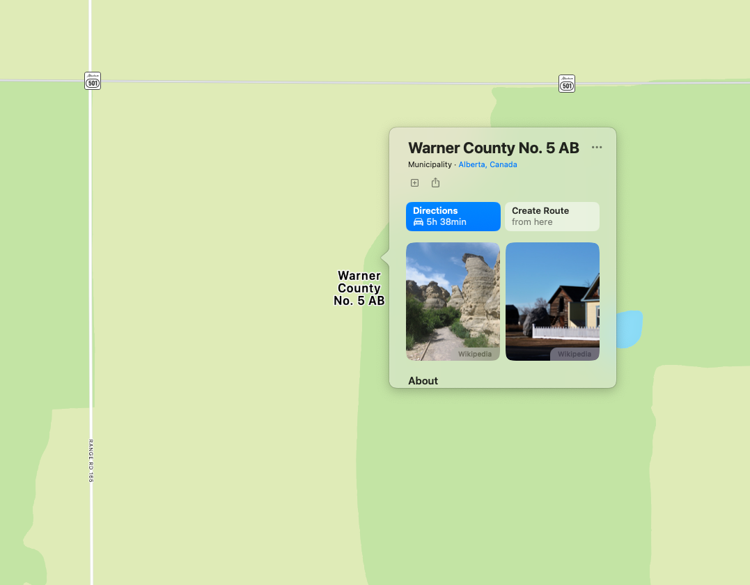

Alternatively, if you pass the coordinate in via Apple Maps URL (https://maps.apple.com/?daddr=49.110,-112.110) it will route but the route is no longer to those specific coordinates, Apple Maps alters them to some nearest known entity (in this case, the RM of Warner County). If you compare the suggested route end destination with the search results for specifically entering the coordinates, you will see they are different locations and mapping routes are not actually taking you to the coordinates anymore.
In the last photo attached, the arrow points to where "49.110,-112.110" is actually located which tapping the "Directions" button cannot figure out a route because of a server issue. If you pass it in via URL, it changes the destination coordinates and begins a route quite a ways away from the intended coordinate.

This is still occurring, here is another example.
  • The first URL in each Apple/Google Maps links shows the coordinate 50.50, -105.50 accurately mapped.

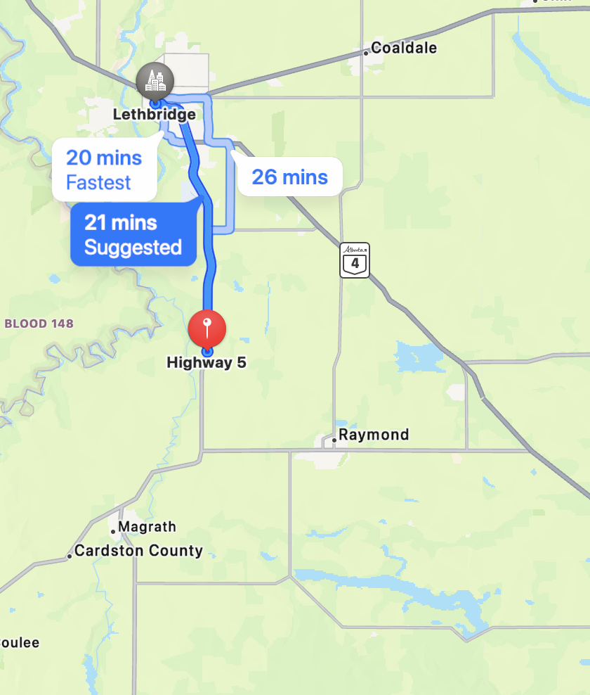

  • The second URL passes in the same coordinate but as a destination address, Google Maps accurately defines a route as close as possible using the roadways, Apple Maps takes you to an entirely different location. Based on my current location, it's physically the wrong direction but that would depend where you set your starting direction.

I've included links to Google Maps which shows the expected result, this is how Apple Maps used to function on May 16, 2024.
I've attached a screenshot showing the results of both Apple Maps links above. You can see the marked location is north of the city of Moose Jaw but the suggested route takes you south of the city and ends nowhere near the marked pin.

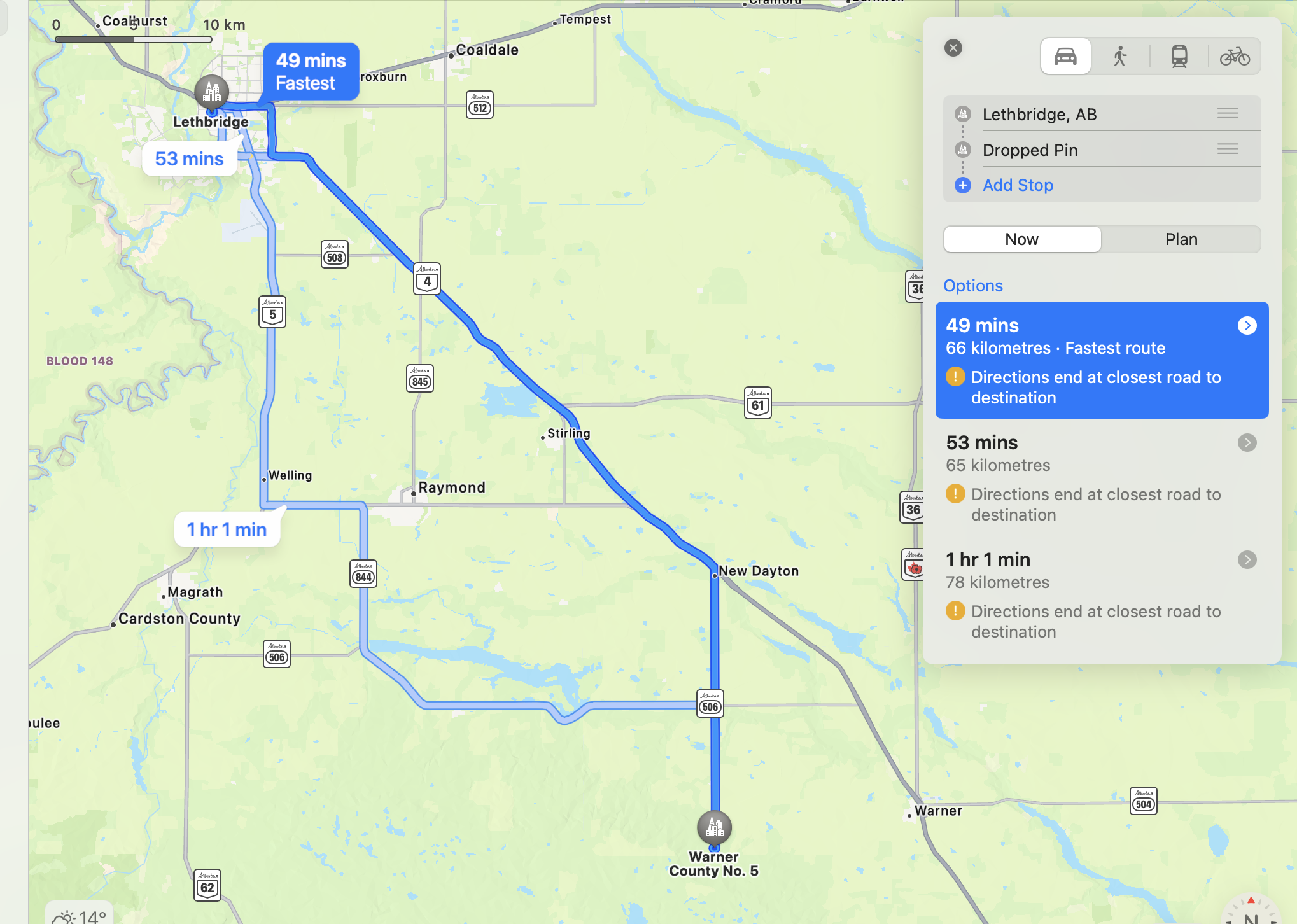

also, I found a wear thing
I open map on Mac, then randomly drop a pin, and make a drive direction (show as screen shot) , then. I do copy the link ( from the top navigation bar, -> Edit -> Copy Link)
https://maps.apple.com/?daddr=Warner%20County%20No.%205,%20Warner%20County%20No.%205%20AB,%20Canada&dirflg=d&saddr=Lethbridge,%20Lethbridge%20AB,%20Canada
afte decode the URL address
    Lethbridge, Lethbridge AB, Canada
    Warner County No. 5, Warner County No. 5 AB, Canada
then I paste the url to a browser, and allow the browser jump back to apple map, the direction is completely away from the original drop pin
