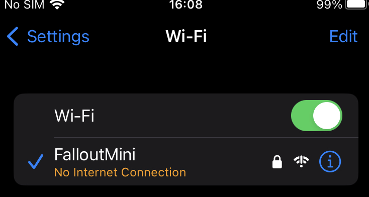

Hello, I'm looking for a way to detect using NWPathMonitor when the iOS device is connected to a router but not to the internet. As an example a mobile router WiFi without SIM.
In settings I'm able to switch the connection to its WiFi, once connected a label below the SSID shows Not connected to the internet. I would like to show the same thing to the user inside my app, but unfortunately I always get the satisfied answer.
Am I missing something in configuring NWPathMonitor or reading the answer?

When you run this test, is the iOS device connected to Internet via WWAN?
I need to clarify your setup here.
First up, are you using Personal Hotspot?
I don’t think you are, so presumably there are two bits of hardware in play here:
  • Your “mobile router WiFi without SIM”
  • Your iOS device
My previous question was about the iOS device. Many iOS devices support both Wi-Fi and WWAN; think iPhone and iPad (Wi-Fi + Cellular). Is that the case here? If so, is the WWAN functioning when you run this test?
Thanks for the clarifications.
If you initialise your NWPathMonitor using init(requiredInterfaceType:) and specify an type of .wifi, do you see different behaviour?
IMPORTANT I’m not suggesting this as the ultimate path forward; it’s just a diagnostic test.
Hello Quinn sorry for for getting back to you late. I tried but still is giving me satisfied as an answer. I also tried with different mobile router each one without SIM, but the answer is the same. Thank you, Andrea

Anyway, at this point I’m going to suggest that you file a bug about this. In general, tools like NWPathMonitor base their answers on local state, which puts limits on what they can do. However, the fact that Settings shows this state indicates that it should be possible for NWPathMonitor to factor it in, and I think it’s reasonable to ask for that.
