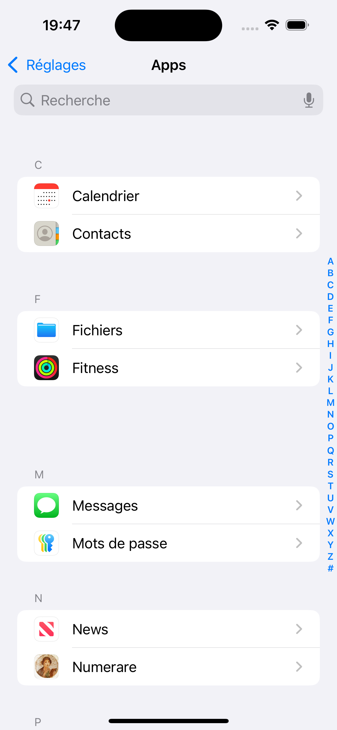

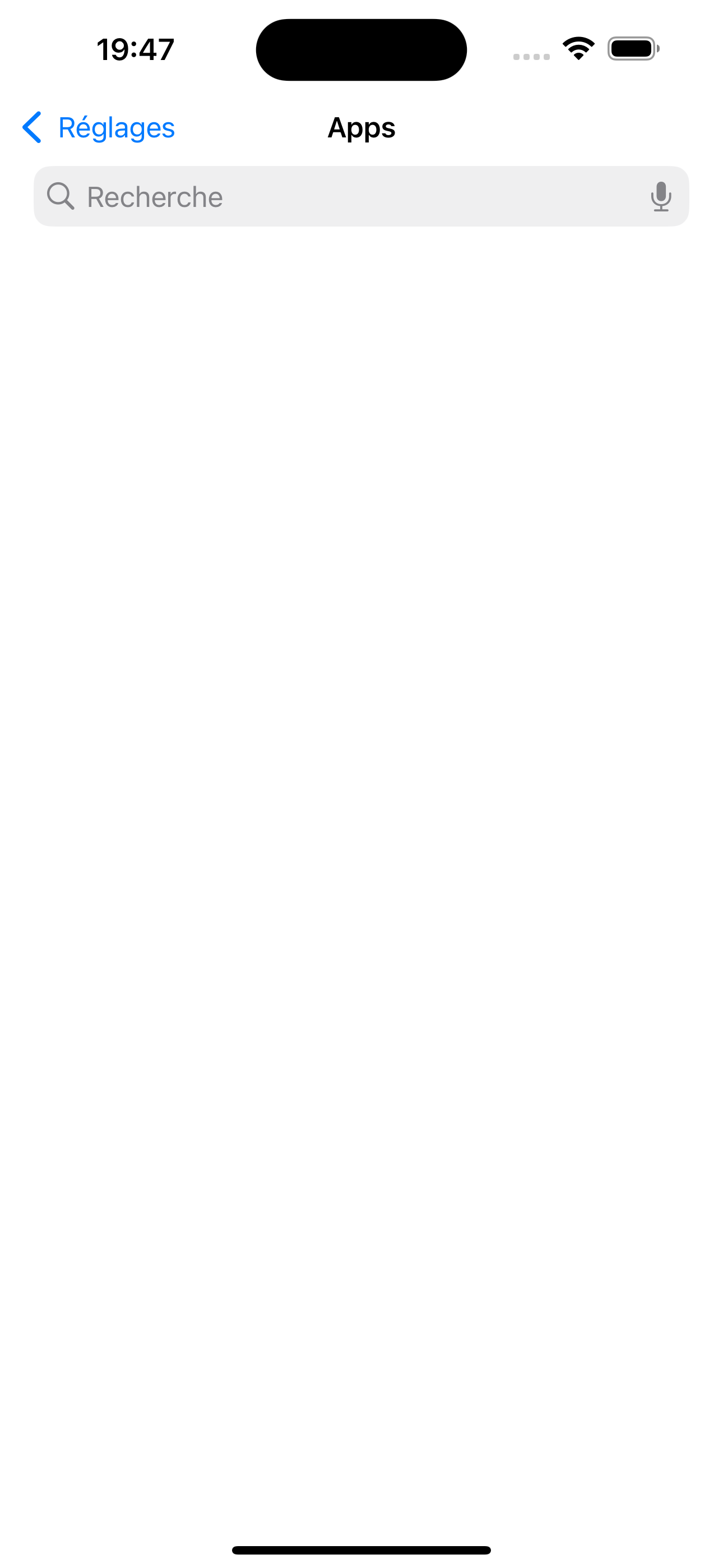

There seem to be several issues with Settings Bundle in iOS 18.2.
They do not appear anymore in the Apps settings in iOS Settings, as exposed here:
So, if it is not deprecated, what could be the reason for not to work, when it worked in iOS 17.4 ?
I also tested for an existing app (published on Appstore). It is a UIKit app.
  • In iOS 18.1 simulator, I see the settings of a lot of apps.
  • In iOS 18.2, not a single app setting. That is a really serious issue.
I filed a bug report: Dec 27, 2024 at 9:37 AM – FB16175635
