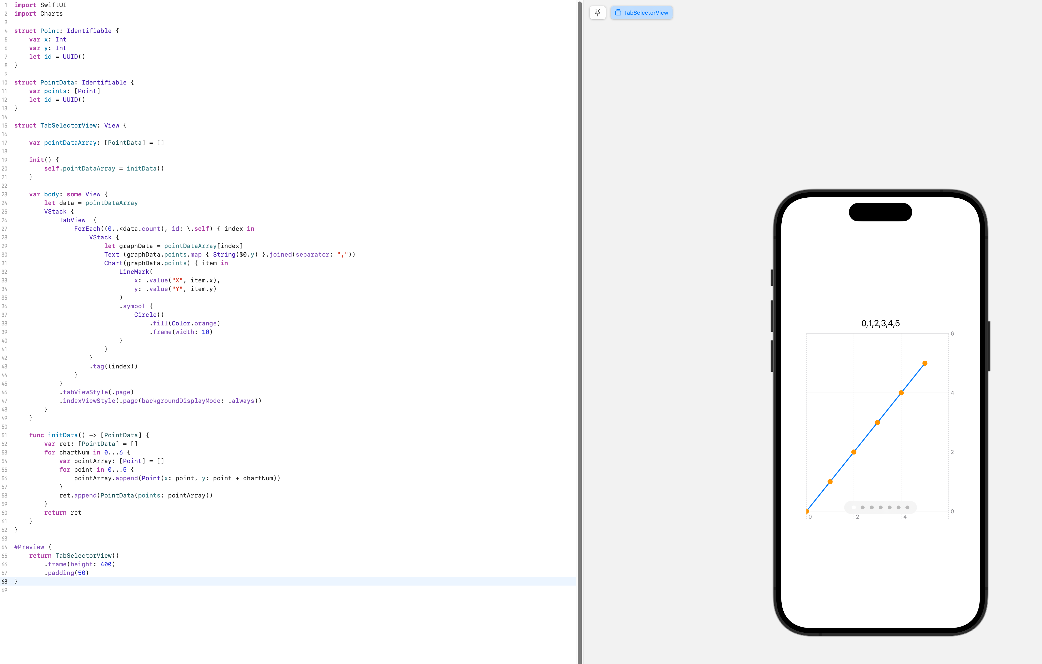

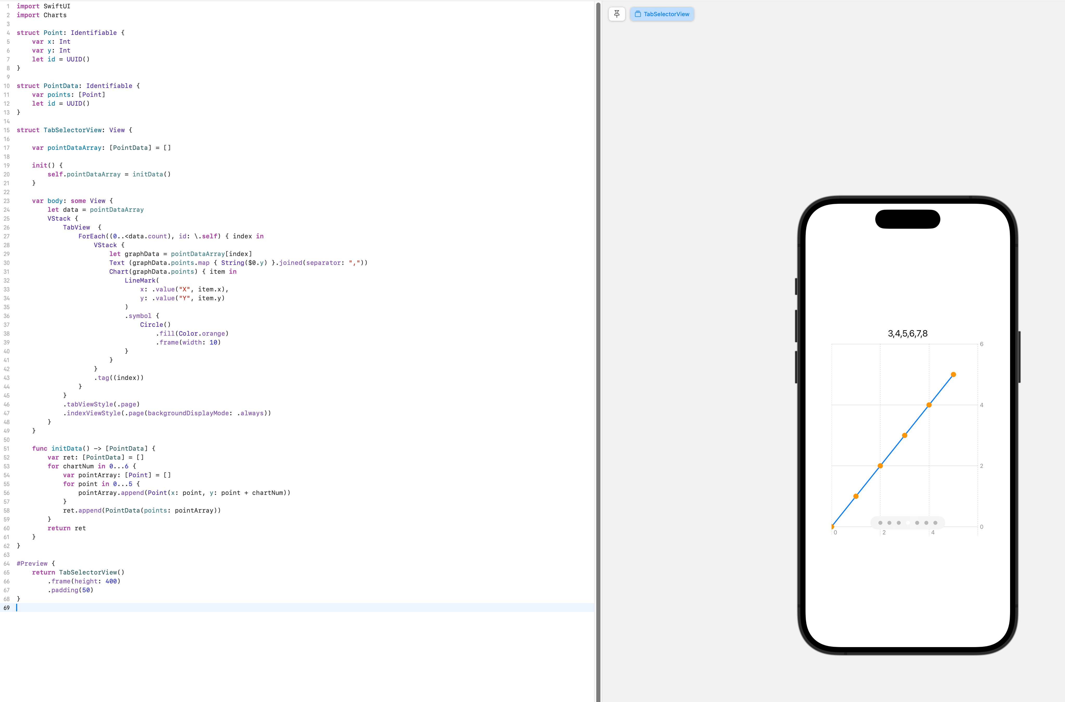

Ok. I have paired it all the way back to a single page of code.
You can see the text at the top of the graph is the Y coords and it doesn't match the chart. If I had included interactivity then tapping on the graph would make it show the correct chart.
Code:

Am I doing something obviously wrong?!
Note that some tab pages are correct and others are incorrect, and it changes as you swipe through.
This time with the correct screenshot!
