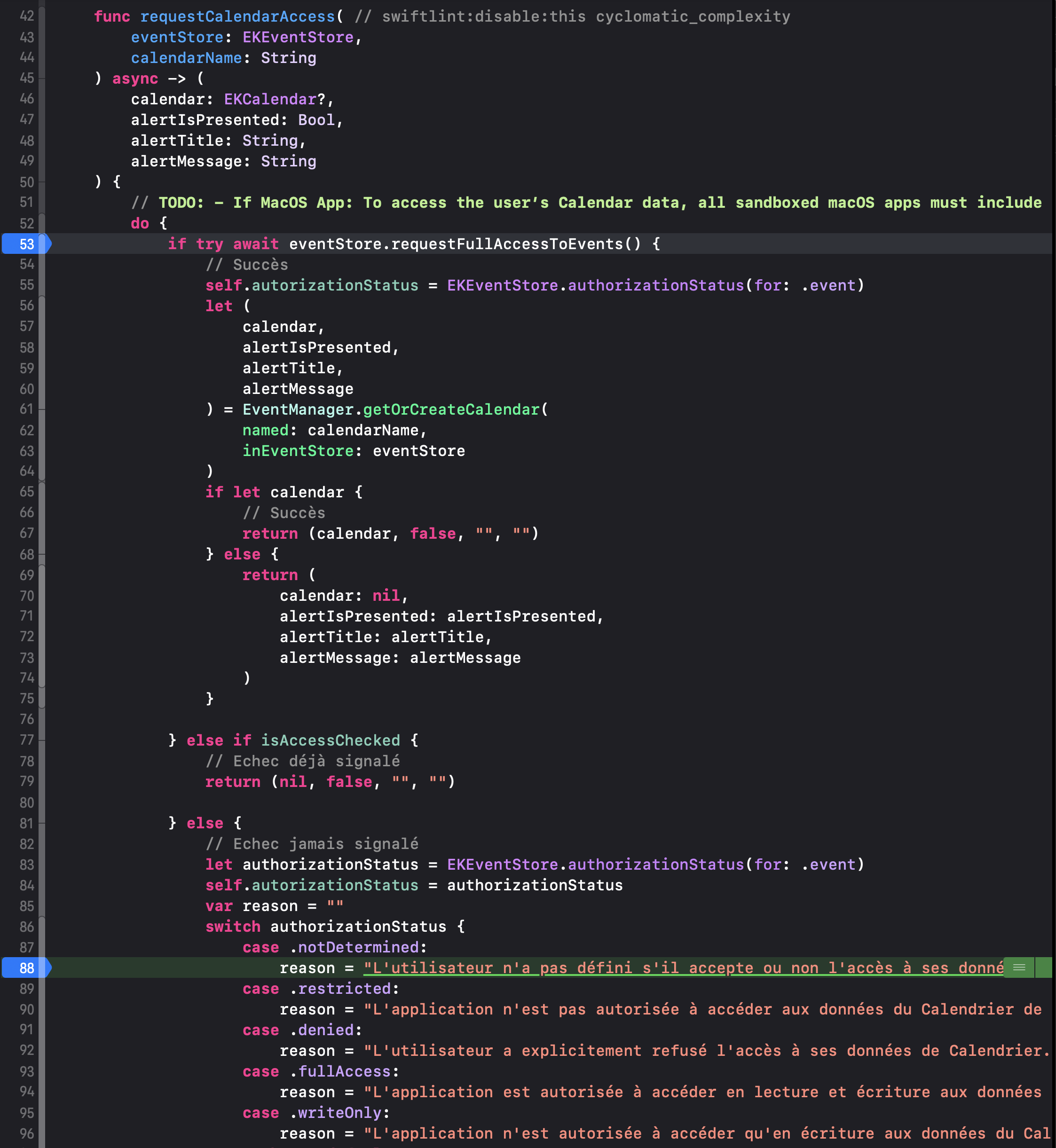

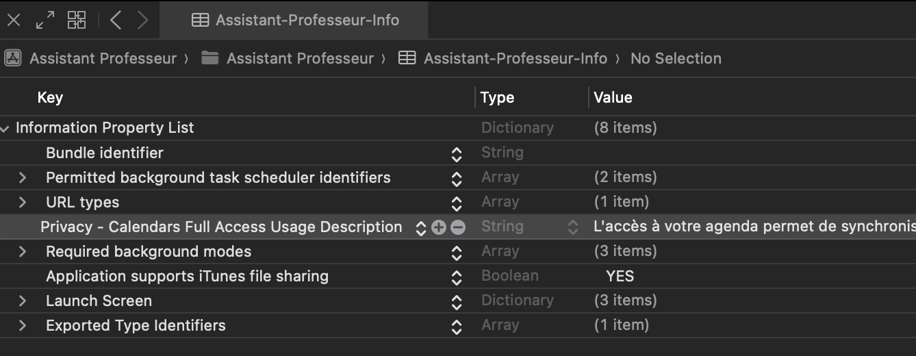

info.plist is correctely updated (see below). I call if try await eventStore.requestFullAccessToEvents() and get a FALSE return (no error thrown). After call returned false I get EKEventStore.authorizationStatus(for: .event) == .notDetermined The user is NEVER prompted by the App for access authorization (no show).

Can you call self.authorizationStatus = EKEventStore.authorizationStatus(for: .event) before if try await eventStore.requestFullAccessToEvents() { to determine your app's authorization status?
If the status is .notDetermined, then your app should call try await eventStore.requestFullAccessToEvents() .
Additionally, to access Calendar data, all sandboxed macOS apps must include the com.apple.security.personal-information.calendars entitlement.
