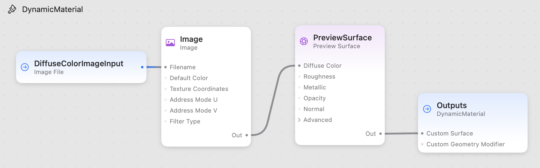

And here is a screenshot of the Shader Graph in Reality Composer Pro:
