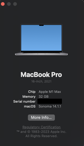

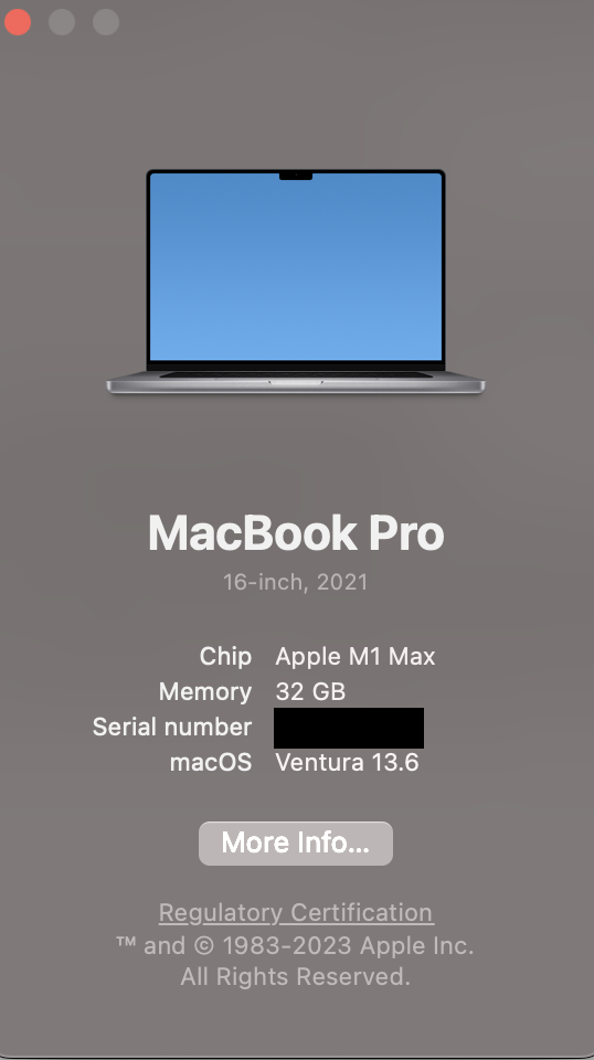

System Info:

@BenjaminApple thank you for your prompt response. I have upgraded to MacOS Sonoma as suggested this morning and conducted further testing to investigate the issue.
File Creation: I generated a substantial number of files (70,000) on the Mac host using the command for i in {1..70000}; do touch "file_${i}.txt"; done.
Listing Files in VZ VM: I navigated to the directory (cd ~/test-file-exhaustion) and listed all the files within the VZ VM.
Initial File Handle Count: Upon checking with lsof, the initial count of file handles associated with com.apple.Virtualization.VirtualMachine was high:
❯ lsof | grep "$(pgrep com.apple.Virtualization.VirtualMachine)" | wc -l
58625
Subsequent Check after 30 Minutes: After a wait of 30 minutes, I rechecked the file handles. Only 482 file handles were closed by com.apple.Virtualization.VirtualMachine:
58143
This test indicates that the issue of excessive open file handles persists even on the latest MacOS version and can be consistently reproduced.
