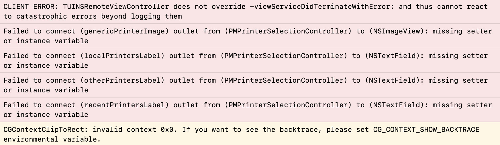

The new macOS version Sonoma 14.4 has just been released. Unfortunately the bug is still not fixed. It is still not possible to print with a "Designed for iPad" app. However, more errors are now displayed in the console:
CLIENT ERROR: TUINSRemoteViewController does not override -viewServiceDidTerminateWithError: and thus cannot react to catastrophic errors beyond logging them
Failed to connect (genericPrinterImage) outlet from (PMPrinterSelectionController) to (NSImageView): missing setter or instance variable
Failed to connect (localPrintersLabel) outlet from (PMPrinterSelectionController) to (NSTextField): missing setter or instance variable
Failed to connect (otherPrintersLabel) outlet from (PMPrinterSelectionController) to (NSTextField): missing setter or instance variable
Failed to connect (recentPrintersLabel) outlet from (PMPrinterSelectionController) to (NSTextField): missing setter or instance variable
CGContextClipToRect: invalid context 0x0. If you want to see the backtrace, please set CG_CONTEXT_SHOW_BACKTRACE environmental variable.
