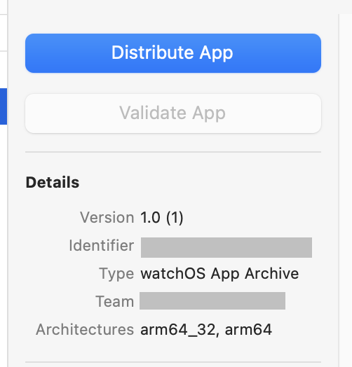

I've been trying to fix this issue and I have tried many things. The problem remains, the "Validate App" Button is disabled. I can build the app on real hardware, but I can't upload it to the App Store Connect.

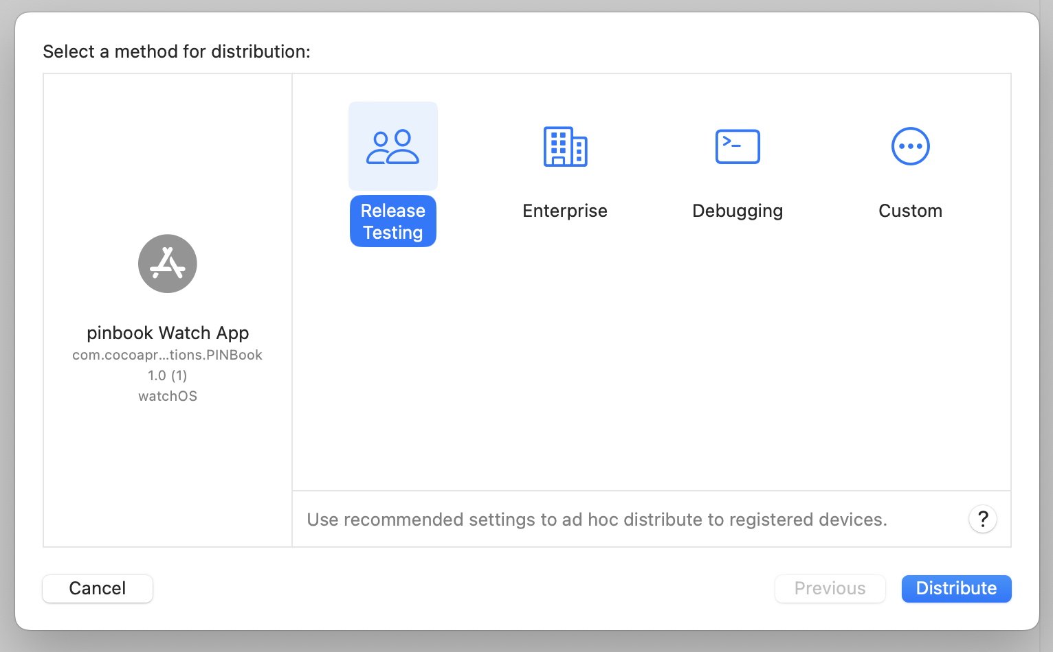

Clicking Distribute opens this sheet, I can export .ipa, but then there will be issue with the Transporter described in the original question. Possibly, Transporter is not yet updated to support watchOS 10 builds. So the Xcode 15 is my only hope.

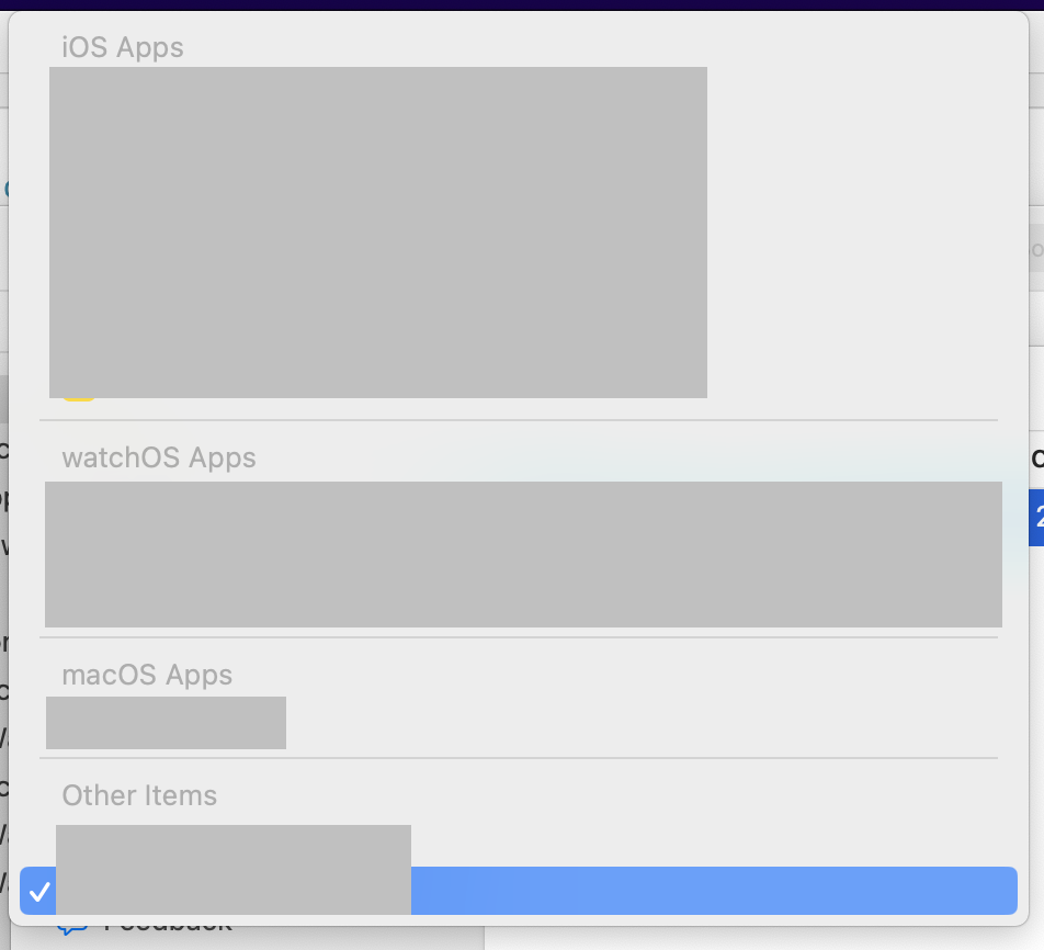

  3. Archiving the product, leads to a problem. The archive is classified as "Other items". I would expect it under "watchOS Apps"
  1. I already know how to fix it by SKIP_INSTALL to YES. And with this change, it's no longer "Generic Xcode Archive", it's "watchOS App Archive"

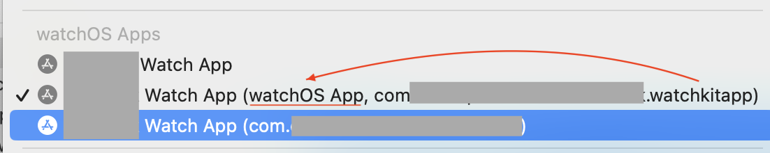

  1. I am restless regarding .watchkitapp, does the bundle ID need to have it? I have tried with and without it, and the only difference I can observe is in Organizer GUI, I can see "watchOS app" in the oval brackets before the bundle ID.

The main problem remains. The "Validate App" button is disabled.

I can confirm this is currently broken (Apr 2025, Xcode 16.3). If you follow the steps outline by Apple in Creating independent watchOS apps when you're ready to submit to the App store, App Store Connect will not work.
Distribute App is replaced by Distribute Contents, and there is no option in the Method panel for App Store Connect or TestFlight.
The only workaround seems to be to create an iOS app target.
Setting the Build Settings for the iOS target to "Skip Install" again leads to breaking the distribution flow, so it seems you must submit an iOS binary if you want to sell a watchOS app. You can at least set your watchOS target to "Supports Running Without iOS Application" for your users, but it looks like you need to pass App Store Review for an iOS app, even if you are only creating a Watch app.
