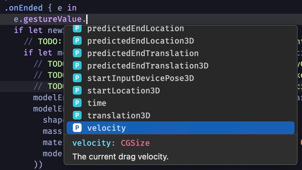

      let velocity: CGSize = e.gestureValue.velocity

How can I calculate the linearVelocity and angularVelocity when the e.gestureValue.velocity I get is just a CGSize?
Is there another prop of gestureValue I should be looking at?
