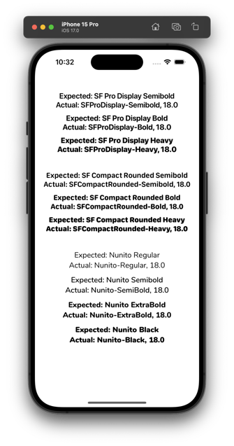

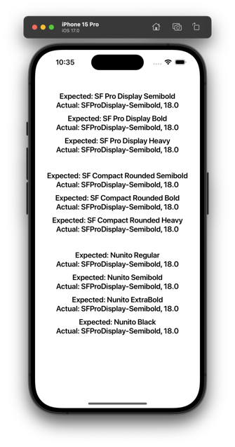

The issue seems to be fixed in Xcode 15.1 Beta 1! Fonts in my test project are loaded correctly now. 🥳 Too bad, we are already setting all fonts from the code 😅
Here is how it looks in Xcode 15.0
