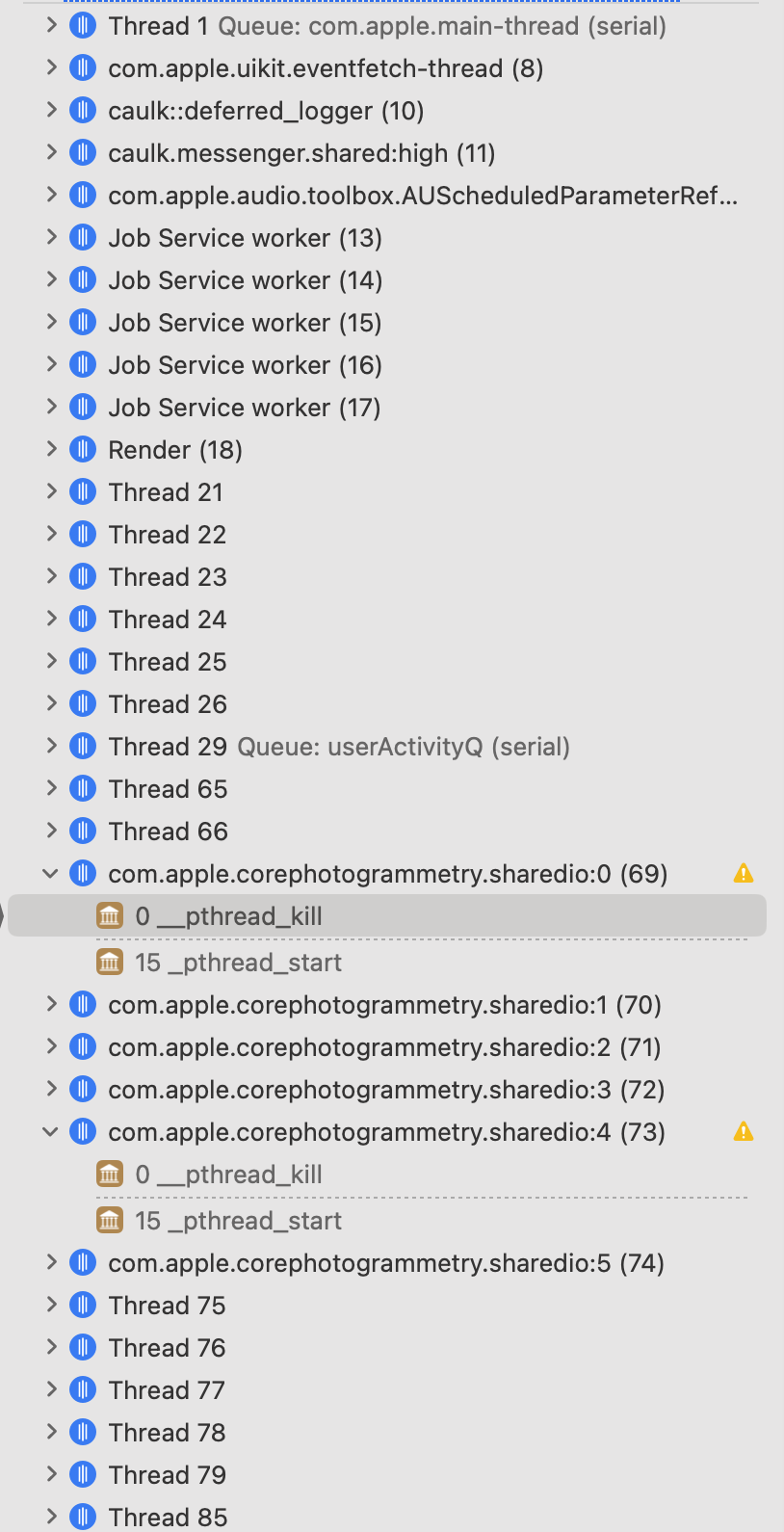

Even with these fixes, there is a crash when reconstructing a lot of pictures: Assert: in line 204
On a smaller batch of pictures it works
I have the same issue, but - at least in my case - it has nothing to do with the amount of pictures. It did also crash one time with just 10 images.
Does someone know something about this issue?
