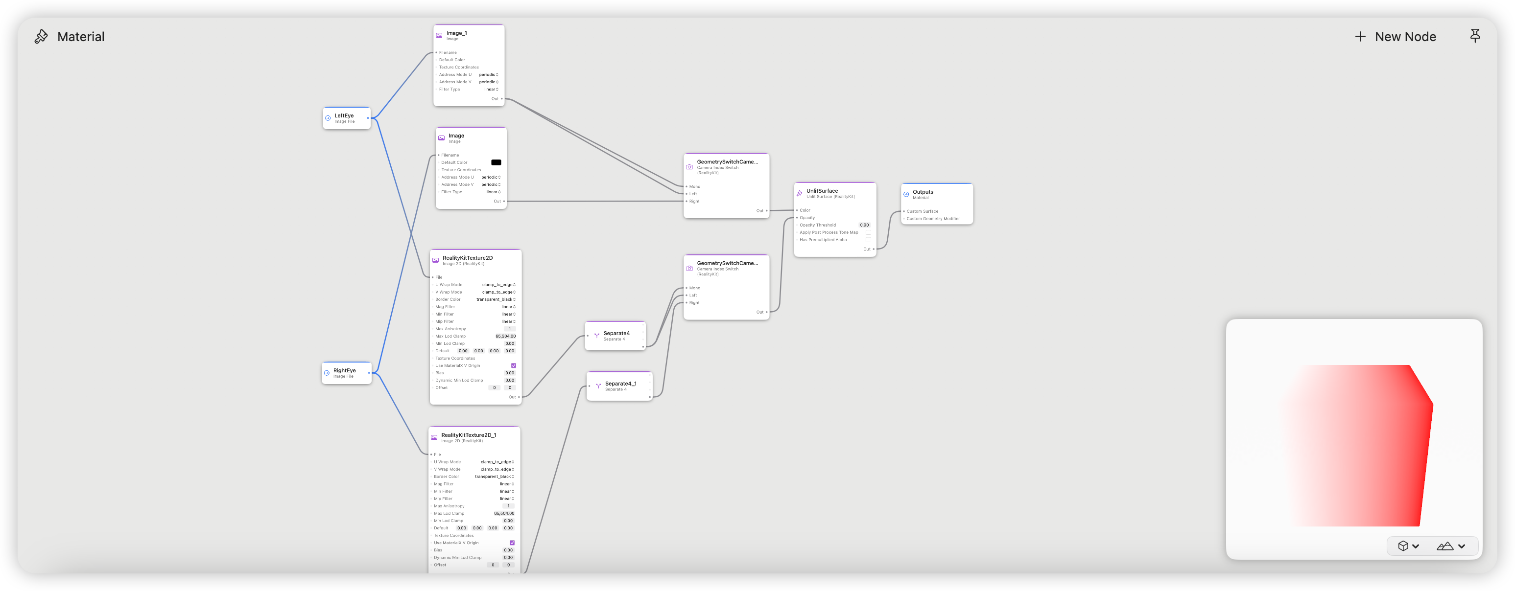

Using Reality Composer Pro, you can make a custom material that feeds the left and right images into a GeometrySwitchCameraIndexNode.
The above Shader Graph from @mayoff works fine for me, using known good stereo image pairs. However, the preview on the Mac shows only a black material. You can only see the stereo output on actual hardware.

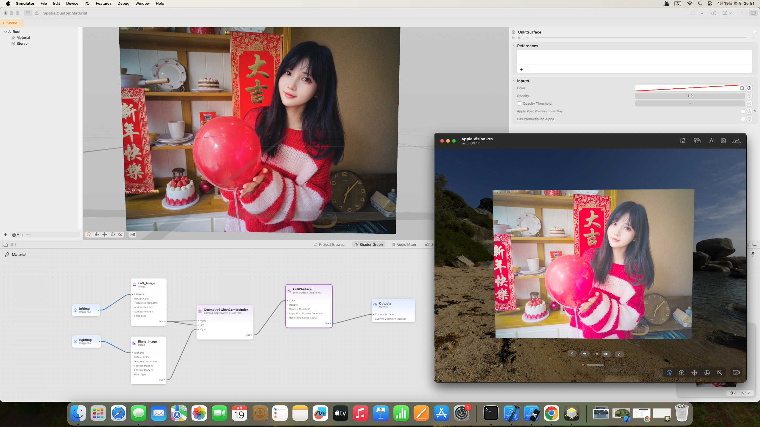

The image shows a color difference between Reality Composer Pro and AVP, with AVP appearing noticeably brighter. What could be the reason for this? @mayoff thx:)
@kandao-xr I Believe that you are seeing this increase of brightness, because on your shader, you are adding the left image for both, LEFT camera index and MONO, that could be drawing two times (duplicating the brigthness of the image) when rendering the left Eye. Could you test just remove the Connection between left-image -> [mono]CameraIndex, to see if will solve?
thx for you repley, i remove mono to check, it's not work, when i use the previewsurface the color seem to normal, maybe it's the unlitsuiface problem
I encountered the same problem but was able to resolve it. A few things:
  1. When you create TextureResource from the image in Swift, make sure you set its semantic to color: TextureResource(image: cgImage, options: .init(semantic: .color)). I was setting it to nil before, and that's what made the images look pale.
  2. Use Unlit Surface node and turn off "Apply Post Process Tone Map"
