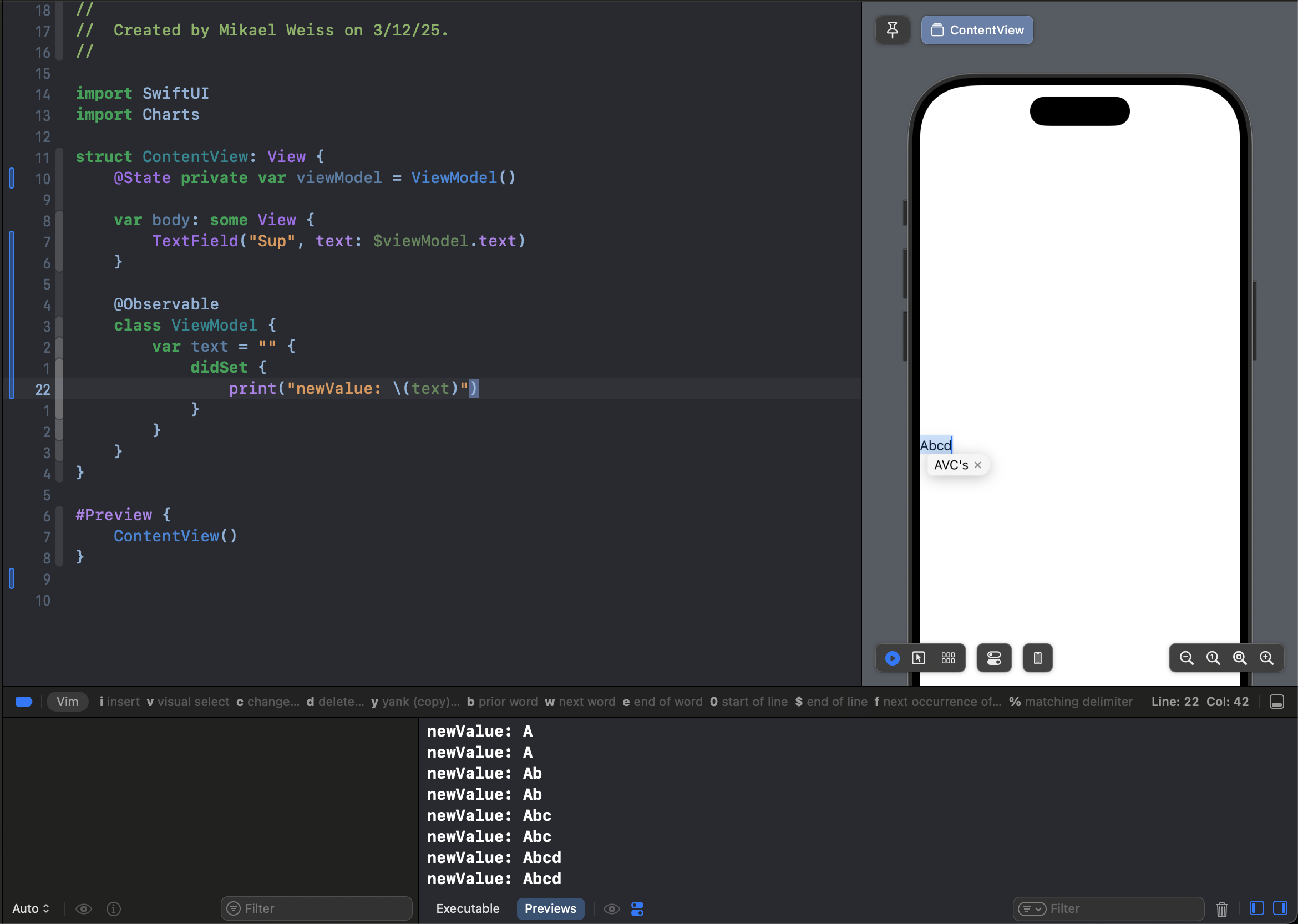

I'm not sure that the conclusion, "You can't use willSet/didSet with @Observable" is correct any longer.
With Xcode 16, the @Observable macro expands a simple String property as shown in the image below. Note that the "didSet" expression is copied to the newly-generated stored property "_name".
Depending on exactly what you're doing in the property observers, they should just work.
From what I can tell, didSet seems to be working now. Swift 5, iOS 18.2
Although, I'm not sure why it seems to be called twice. That is weird to me.
