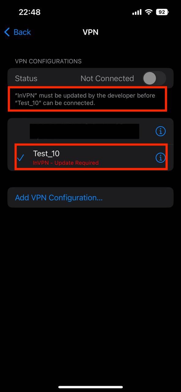

Application is builded, installed on iPhone and launched from XCode. After a new VPN configuration is added by application using NETunnelProviderManager. No errors are occurred during all this steps. However I can not enable VPN and in VPN settings I observe "Update required" message:
"Application must be updated by the developer before VPN can be connected"

The issue could be related to your Extension minimum deplayment and your host applicaitions minimum deplayment difference.

My issue was not matching deployment targets between extension and hosting app
