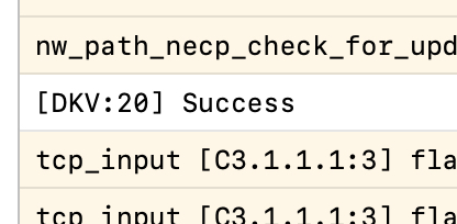

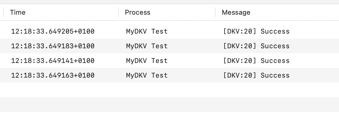

Is it normal for log messages to get duplicated?
and in the console app:
Each log message has a unique number, so I'm pretty sure my app is not logging this 4 times (and it only shows up once in Xcode)
That’s certainly weird. Please start a new thread and we can discuss this there (it’s the exact opposite of the subject of this thread! :-).
