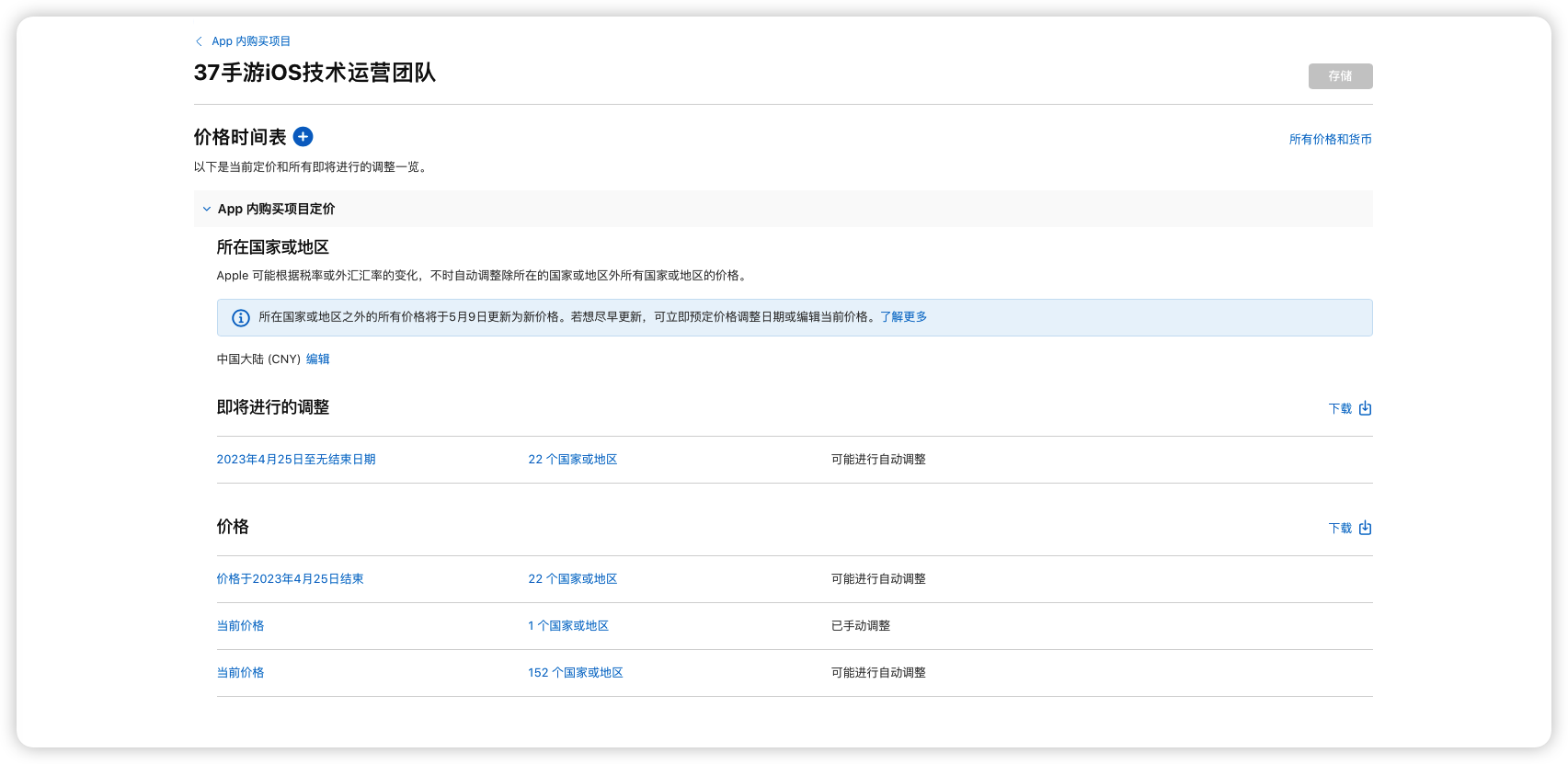

Finally, there is another note. In our example, the benchmark country mainland China (CHN) sets the global equilibrium price from now to the CNY¥ 2.50 price point used by 2023-04-25, starting from 2023-04-25, so that Set the global equilibrium price with the CNY¥1.00 price point. The exception is Hong Kong, China. From now on, it has been manually adjusting the customised price HKD $16.00. But the price schedule displayed in the background of Apple ASC:
Only 22 countries or regions will follow 2023-04-25 for automatic adjustment. The remaining 152 countries or regions, because the global equilibrium prices corresponding to CNY¥1.00 and CNY¥2.50 in the benchmark countries are the same price point, so they will not be automatically adjusted with 2023-04-25. It should be noted that the subsequent Apple price adjustment plan is also affected by factors such as foreign exchange rate or tax rate adjustment.
Summary, the rules that must be followed when setting the interface of a price adjustment (IAP level) of an IAP:
  • The baseTerritory base country must be set
  • Time schedule of price points in the benchmark country, necessarily covering all time periods
  • If it is a custom price, it must be listed at the price point of each country, and multiple countries cannot be specified in batches
  • A time schedule with a custom price, can only include a startDate or endDate, or a full time period when both are empty.
