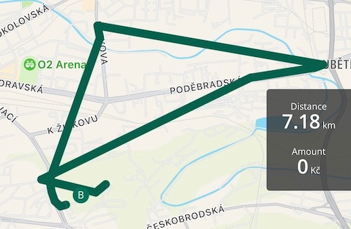

I have competitor apps installed for the automatic mileage tracking, and 2 of 5 (all that really track) recorded now something like:
That would correspond to points in the significant location updates, maybe. No recording in between.
That's going to be interesting.
