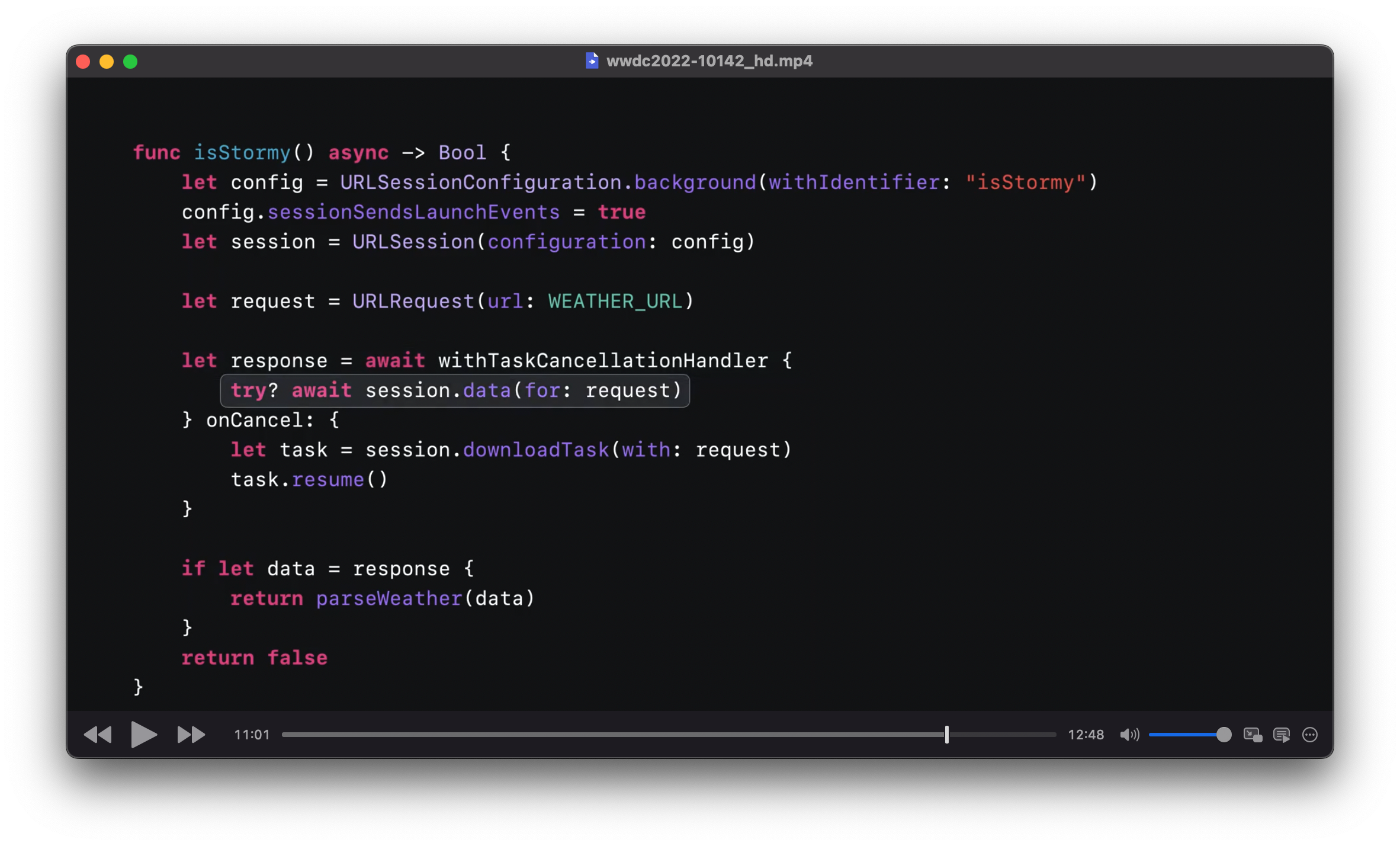

When I try to implement the new Background Task options in the same way as they show in the WWDC video (on watchOS) likes this:
let config = URLSessionConfiguration.background(withIdentifier: "SESSION_ID")
config.sessionSendsLaunchEvents = true
let session = URLSession(configuration: config)
let response = await withTaskCancellationHandler {
      try? await session.data(for: request)
} onCancel: {
      let task = session.downloadTask(with: request))
      task.resume()
I'm receiving the following error:
Terminating app due to uncaught exception 'NSGenericException', reason: 'Completion handler blocks are not supported in background sessions. Use a delegate instead.'
Did I forget something?

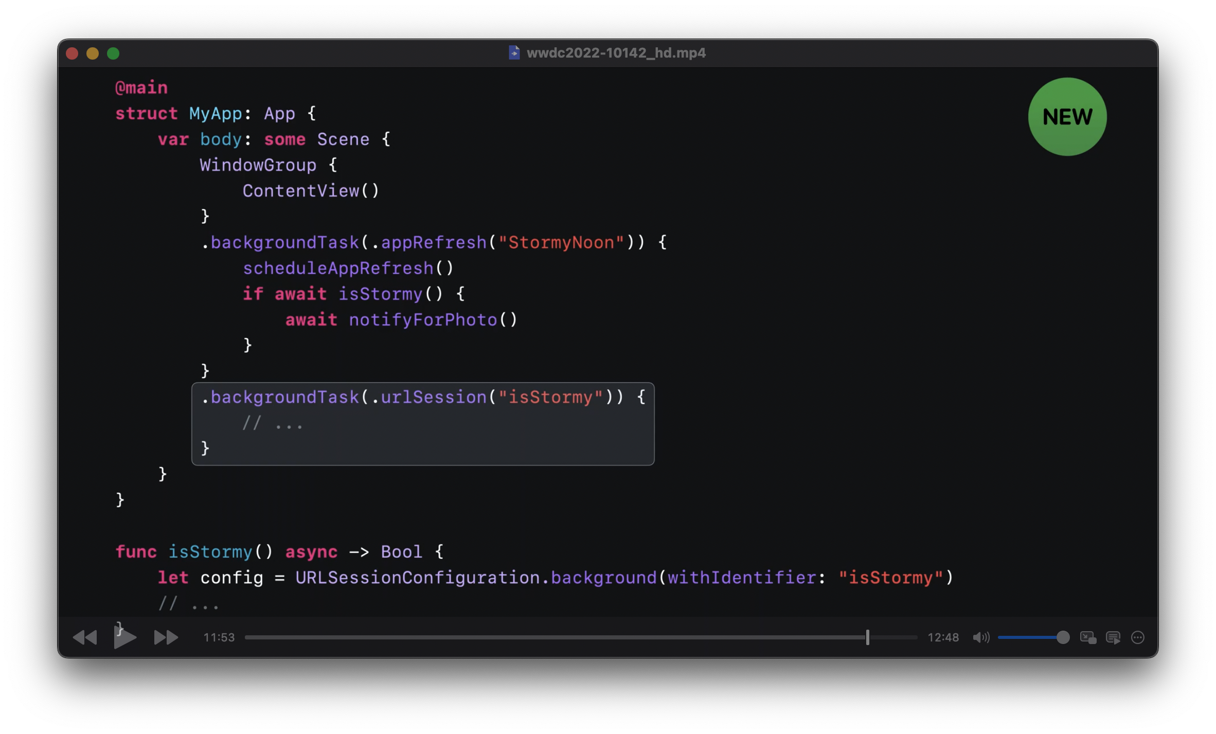

Howdy!
I found this thread and wanted to let you know that I believe I managed to suss out a way to make the omitted parts of the API usage work. It ain't pretty, but here goes.
.backgroundTask(.urlSession(my_id_goes_here)) {
  await downloadManager.waitForBackgroundEvents()
I think key here is that the async waitForBackgroundEvents() function is not allowed to return until our background url session reports that it's finished. Here's how I did that:
func waitForBackgroundEvents() async {
  let task = Task {
    await withCheckedContinuation { continuation in
      self.continuation = continuation
  _ = urlSession // trigger lazy initialization of the background url session with relevant identifier. Crucially, this hooks up the delegate which allows processing of events to happen.
  _ = await task.value // The task is completed by resuming the continuation in response to urlSessionDidFinishEvents(forBackgroundURLSession session: URLSession). Not sharing those parts
Sadly, the backgroundTask APIs and URLSession APIs don't really work well together. I think one could imagine a future where some new async addition to URLSession lets you capture the background events in one simple call.
