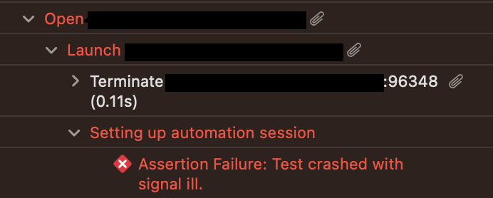

Assertion Failure: Test crashed with ****** ill.
I get this error from time to time in UI tests when they are run on CI. Any ideas what might be causing this error?

@DTS Engineer Dear Apple, kindly bump this issue. Xcode Cloud Test action always fail with the same error - " App Name (7274) encountered an error (Early unexpected exit, operation never finished bootstrapping - no restart will be attempted. (Underlying Error: Test crashed with ****** ill before starting test execution.)) "
I'm also seeing this consistently within Xcode Cloud, but haven't seen it locally. I've downloaded the crash log bundle, and it contains one for AccessibilityControlsExtension and a bunch for MercuryPosterExtension (examples attached). I don't really know what either of those things are, but can't find any references to my code in either.
I was able to work around this issue by setting the Host Application to "None" for my test scheme. This stops Xcode Cloud from attempting to start up the application binary.
