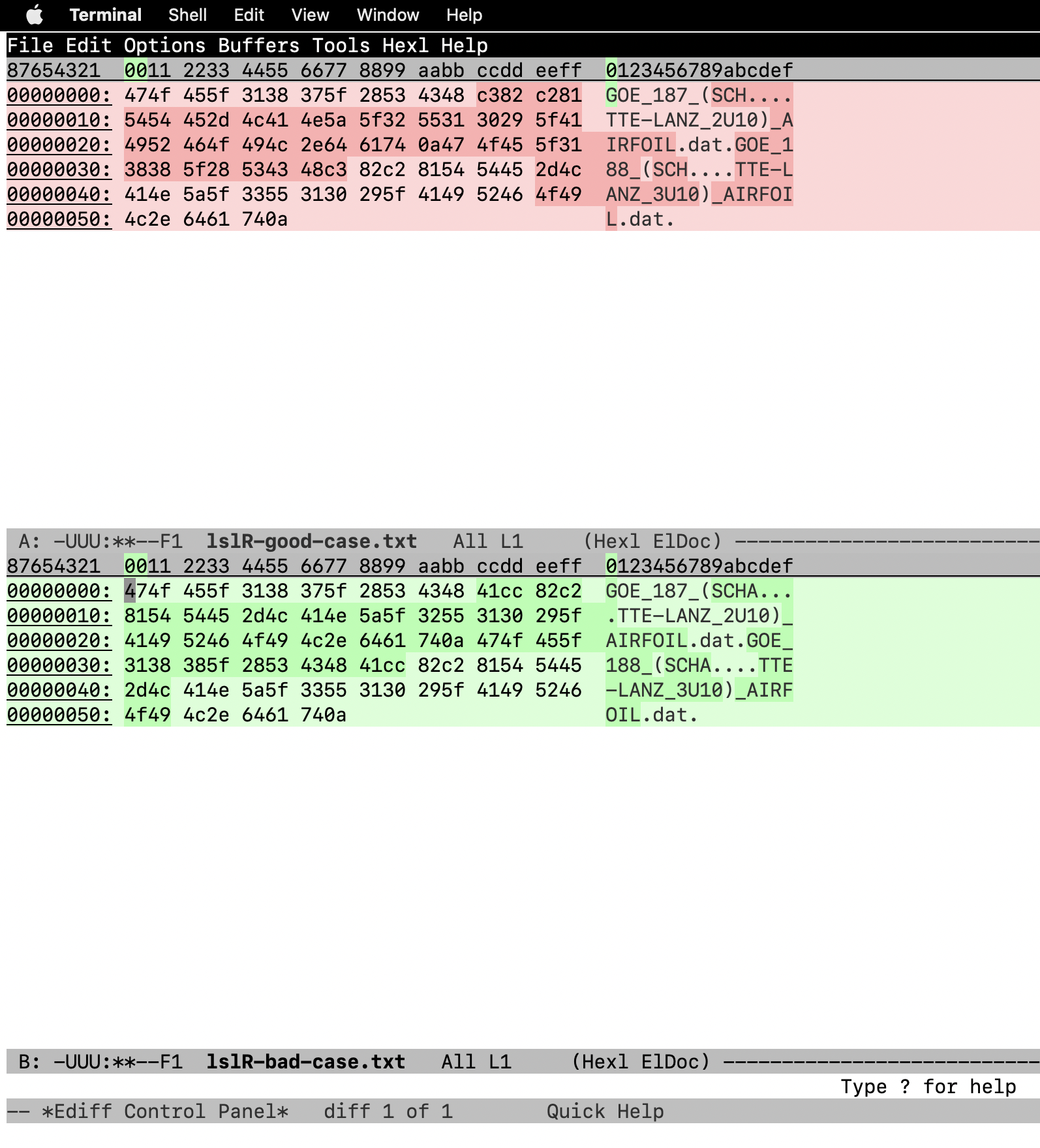

HOWEVER: further examination has revealed, that the output of "ls -alR" does show some differences depending on whether the copy was done in finder or on command line! I think the difference that might be of relevance considers "non-ascii" characters in file names. Here is what I mean (reduced to the part of the "ls -alR" output that is showing the difference - only actually visible in HEX). Can that be important?

However, I think you’ve already found the issue here:
"non-ascii" characters in file names … Can that be important?
Yes. This is a known issue with code signing (r. 68829319). In Unicode many characters can be rendered in different ways. For example, an Á (A acute) can be encoded either precomposed, as U+00C1 (LATIN CAPITAL LETTER A WITH ACUTE), or decomposed, as U+0041 U+0301 (LATIN CAPITAL LETTER A followed by a COMBINING ACUTE ACCENT). If copying the files changes this rendering, it breaks the code signature.
On HFS Plus this was rarely a problem because all file names were canonically normalised. However, APFS is normalisation preserving [1], which means that the rendering of your file names can vary based on how you copy them. That’s why a Finder copy breaks the code signature but ditto does not.
Ultimately this is Apple’s bug to fix but, right now, the only good solution is to stick to ASCII file names within your bundle.
[1] It’s also normalisation insensitive but that only goes so far. The way that code signing uses the file system means that this normalisation insensitivity doesn’t help it.

man, you're the absolutely best! Thanks - this is indeed what was wrong! After copying the correct files over the "faulty" ones, the problem was gone. The "codesign -v -vvv...", as you suggested, even told me exactly which files were problematic. All of them had non-ascii characters in their file names!
