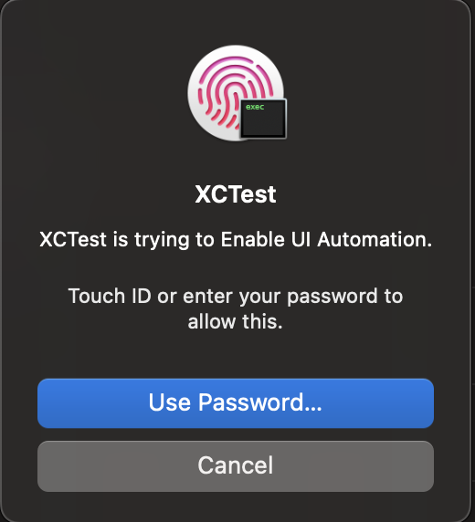

Please help the following is the password that XCTest was requesting on my Mac:
This is required for the Mac, for iOS it runs without asking for password, So I am wondering if this is the reason why XCTest for the Mac doesn't run on Xcode Cloud.
