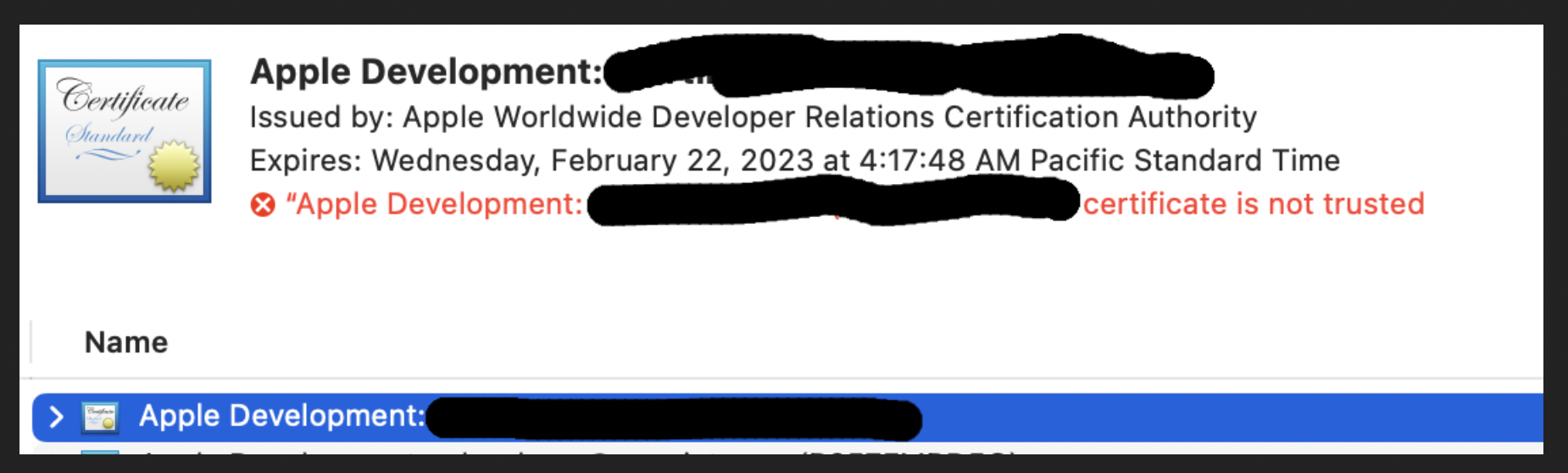

After not happening to me for a few months, this issue has started hitting me again with currently %100 reproducability.
If turn on VPN on my Mac then instantly the developer certificates within the keychain become untrusted. But that's not all, if VPN is then turned off the certificates do not revert to their trusted status but remain untrusted.
The consequence of this is that if VPN is turned on and then a build is perform, it fails, and the only way to fix things is to delete the cert(s) from they keychain and re-install them.

I'm facing this exact same problem. And the only solution is to delete the certificate from Keychain Access, which lets Xcode prompt me to revoke it, then Xcode generates a trusted one the next time, then the cycle repeats and it happens every time.

My team came up with a "certificate kick" to workaround this.
Open Keychain Access.app Double-click on the said certificate Change to Always Trust, close the panel Open the certificate again Change it back to Use System Defaults Close the panel.
This is annoying but these steps works _(ツ)_/¯ At least it's better than rebooting or revoke and get new certificates.
I wish there is a way to script this. (or just fix whatever needs to be fixed somewhere) :).

I just started running into this a few days ago and I'm not sure why. Same behavior as described above. Everything is working fine, then I need to connect to a VPN for work and when I disconnect from the VPN and try to build the app again and deploy it to the phone, it fails with:
Warning: unable to build chain to self-signed root for signer "Apple Development: {redacted} (redacted)"
Command CodeSign failed with a nonzero exit code
There is also mention of errSecInternalComponent.
If I open keychain on my Mac, I see that my development certificate now says that it's not trusted. And indeed, as julian99 stated, if I change the trust settings to "Always Trust", close that window, re-open the certificate again, change the trust settings back to "Use System Defaults" and then close the window again, it "fixes" the problem.
