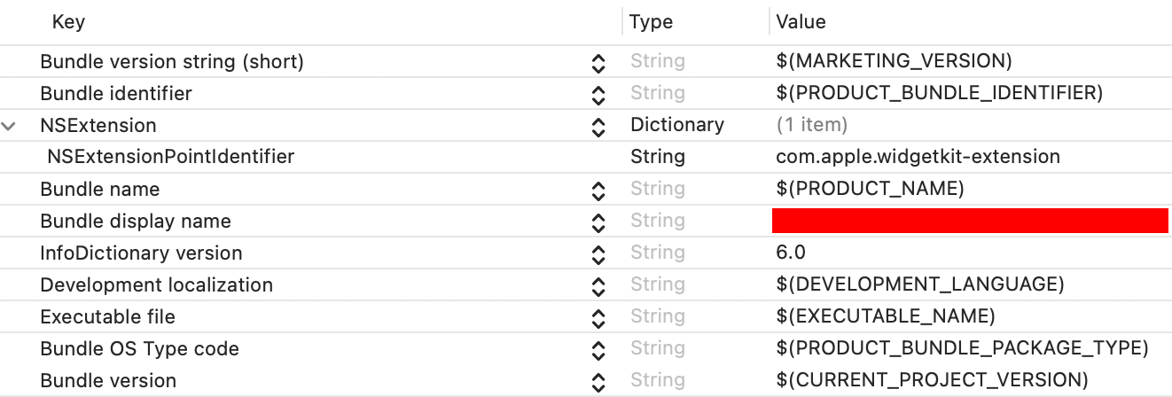

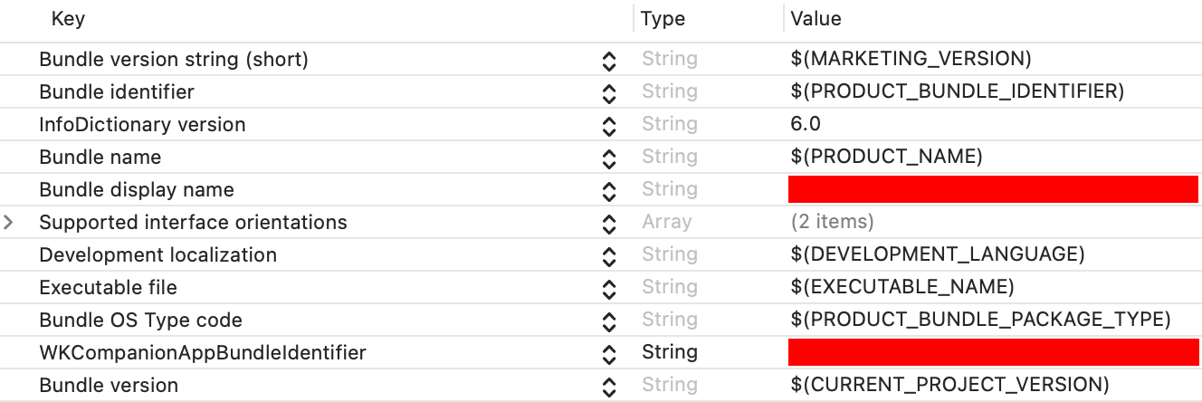

Here's what I've got. Main App contains Widget and WidgetIntentHandler, plus Watch App, which contains Complications and ComplicationsIntentHandler.
Target: Main app: (I've removed everything that has no bearing on extensions.)
Target: Widget:
Target: WidgetIntentHandler:
Target: Watch App:
Target: Complications:
Target: ComplicationsIntentHandler:

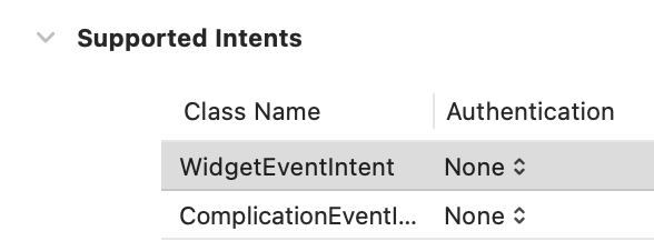

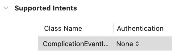

This is what I have in the various "Supported Intents" sections of the targets...

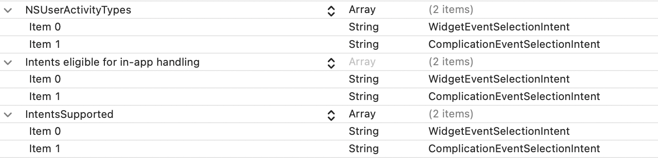

Main App:
Okay, so the Main App supports the two intents.

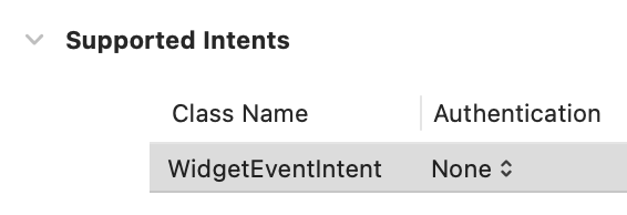

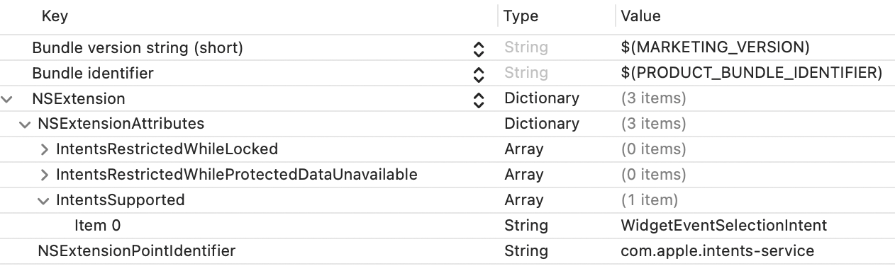

The WidgetIntentHandler supports only the WidgetEventIntent.

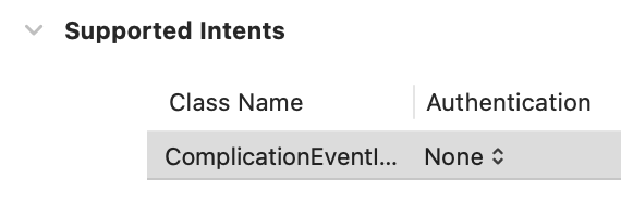

Watch App:
The Watch App (which contains the Complications and ComplicationsIntentHandler targets) supports just the ComplicationEventIntent.

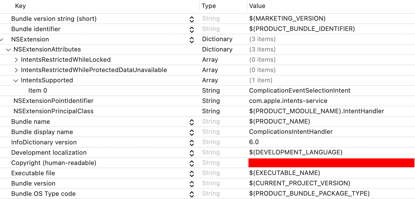

And the ComplicationsIntentHandler only supports the ComplicationEventIntent.
What am I doing wrong? I've told the Main App that there are two intents. I've told the WidgetIntentHandler to support only the widget intent, and the ComplicationsIntentHandler to only support the complications intent. There are no other places to set up "Supported Intents".

In the General tab of the project view:
  • Main iOS app has both supported intents listed (WidgetEventIntent and ComplicationEventIntent).
  • Widget target does not have any supported intents because there is no section to add them.
  • WidgetIntentHandler has both intents listed.
  • Watch App has only the ComplicationEventIntent.

  • ComplicationsIntentHandler has only the ComplicationEventIntent.

  • WidgetIntentHandler has only the WidgetEventIntent listed.
