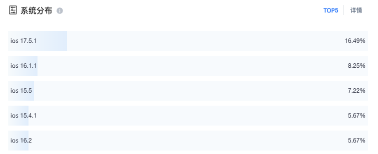

Hey, I came to the same crash, and got no idea about this. do you have any progress
Hi, @moonkake. I'm still unable to resolve this crash. The crash seems to be quite common based on the crash statistics for my app. Here is all the information I have regarding these crashes:
  • The crash is sporadic and I have not been able to reproduce it manually.
  • It only occurs on devices running iOS 16.*.
  • The crash can happen on both iPhones and iPads.
  • It doesn't seem to be related to low memory.

Hi, @webd . The workaround you described works like a charm. After implementing it, there have been almost no crashes on iOS 16.* related to PDF printing. Thanks a lot!
It's not just iOS 16, every version will crash
