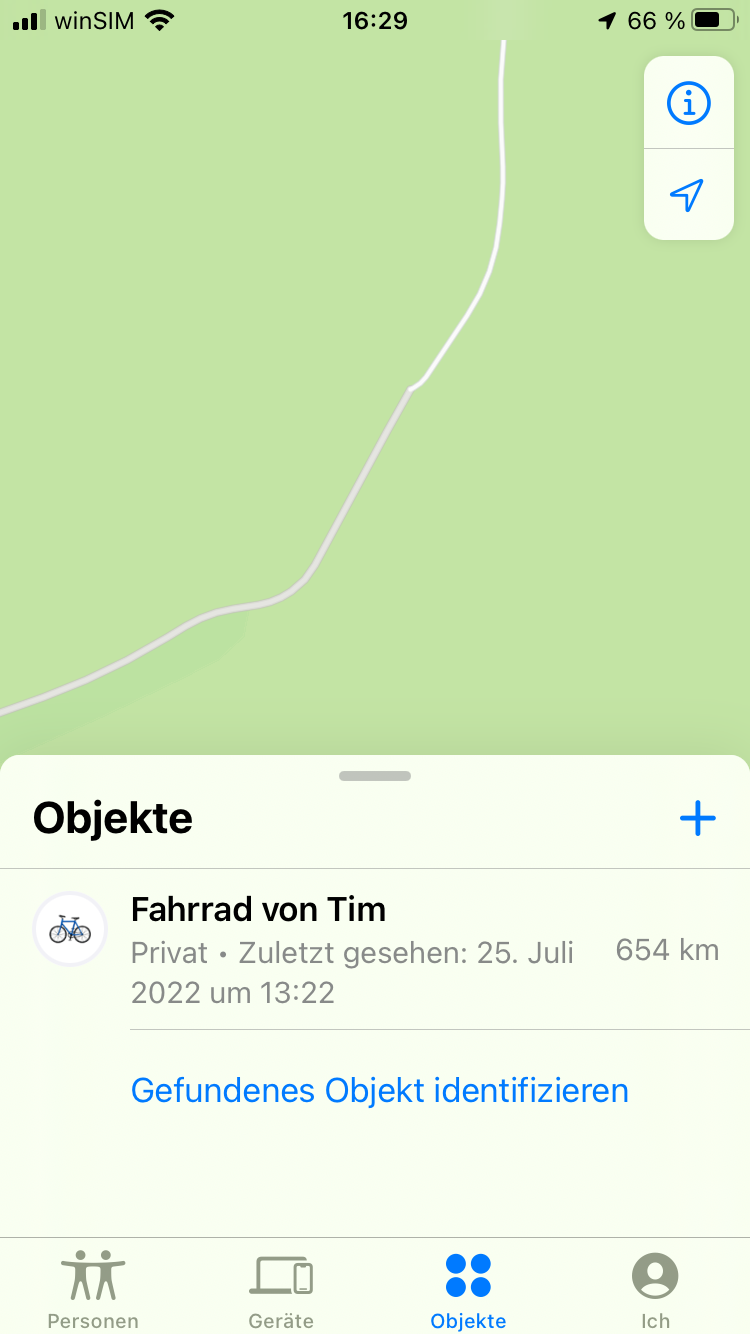

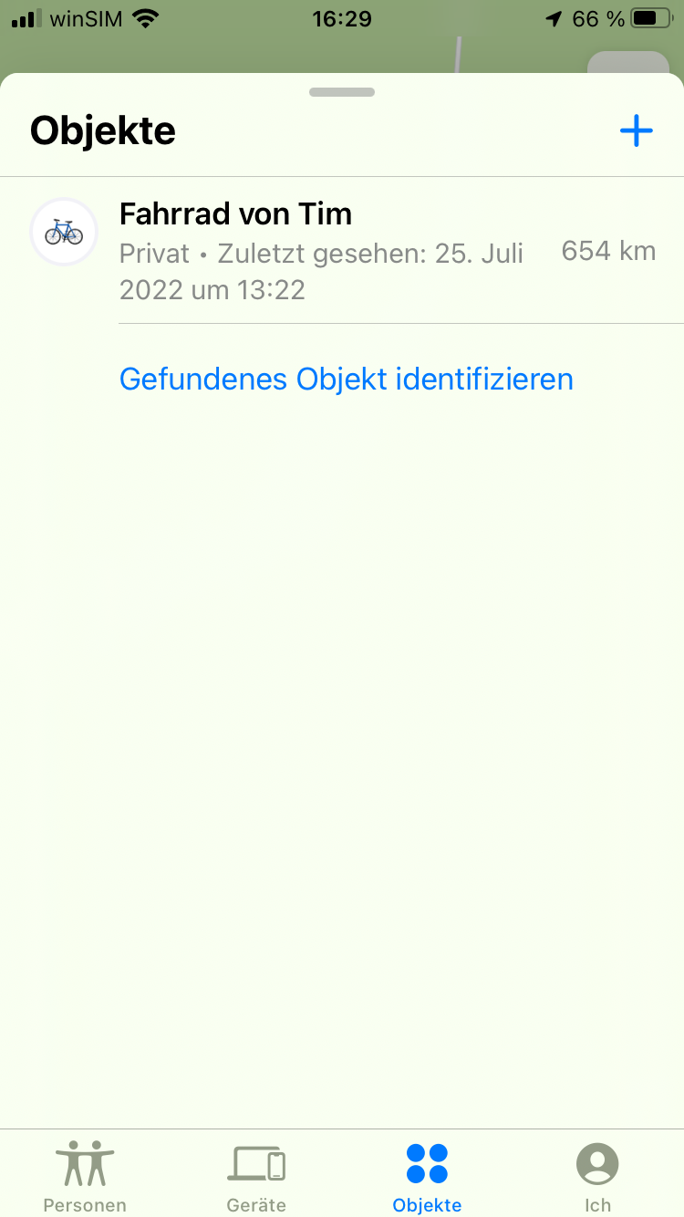

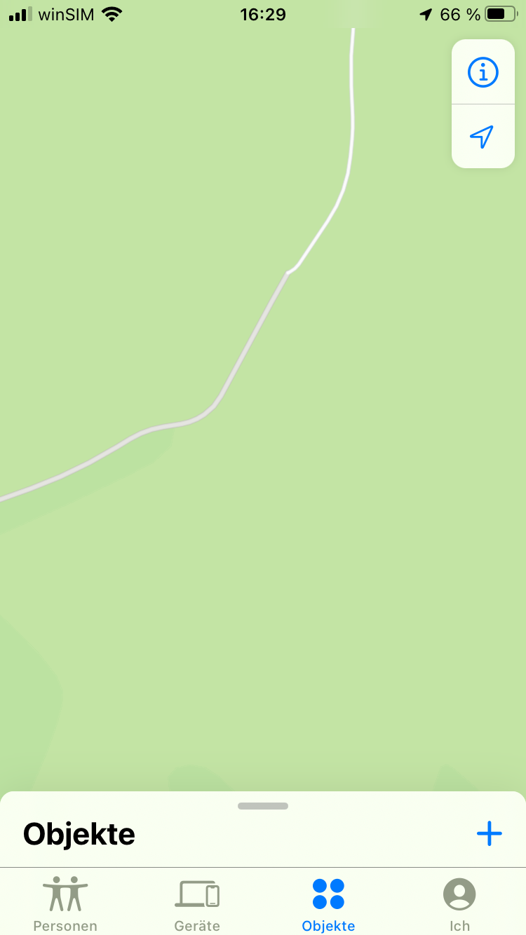

I would like to include the bottom sheet from the iPhone "find my" and "maps" app in my app. During my research I came across the new modifier .presentationDetents for sheets. The only problem here is that you can no longer interact with the main screen when the sheet is active. In my app, however, I would like the sheet to be active all the time like in the iPhone apps mentioned and that you can still interact with the main screen like in the iPhone apps with the map. I would be very happy about help. Greetings
