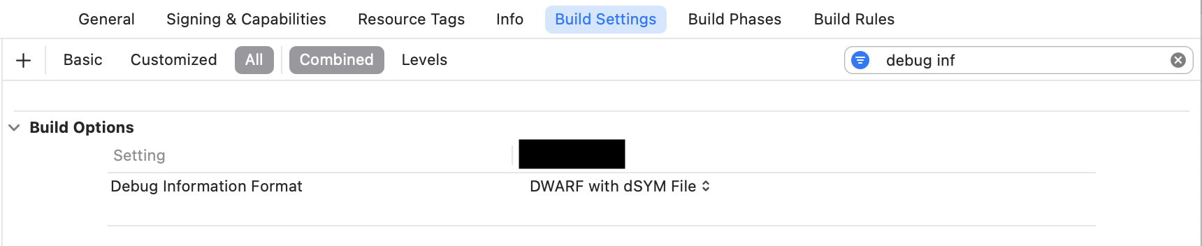

I doubled checked the Debug Information Format setting for my main target and it's set to DWARF with dSYM File. (Screenshot included.)
I also did a new archive for both iOS and Mac (Catalyst), with no code or configuration changes between the two aside from the build number. When I inspect the contents of the archives, the dSYM for the main app is present in the iOS archive, but not the Mac archive. I'm using Xcode 13.3.1 and MacOS 12.3.1.
