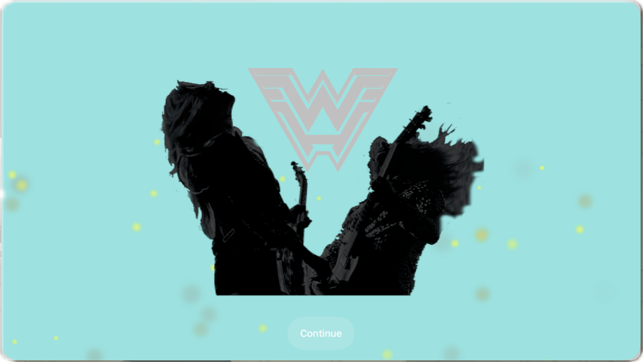

In my case, I created a plane in Blender with a texture image with an alpha mask. When I view the USDZ in visionOS on a device or the simulator, the mesh is quite dark. I am loaded the scene with Model3D & not a Reality Kit view (for various reasons).
