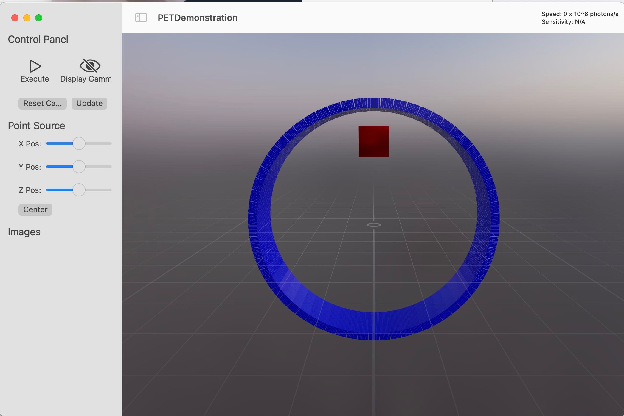

I am creating a RealityKit scene that will contain over 12,000 duplicate cubes arranged in a circle (see image below). This is for some high-energy physical simulations I am doing. I accomplish this scene by creating a single cube and cloning it a bunch of times. So, I there is a single MeshResource and Material even though there are a lot of entities. I have confirmed this by checking with Swift's === operator. Even with this, the program is unworkably slow.
Any suggestions or tricks that could help with this type of scene?

I am including the important code at the end of this post. I should note that I put this entity into an ARView that has an environment.lighting.resource and an environment.background as you can probably see from my original attached image. I am currently testing whether getting rid of these helps performance but I am not expecting a big difference. I generated a RKView subclass of ARView that is basically recreating SceneKits display mode that allowed for mouse camera control, and 3D display without augmented reality since my applications are not really augmented-reality based and more virtual-reality based.
Finally, I summarize the code by noting that I create a single Box Entity with one material. I then clone this entity in an 8x6 grid. Finally, I clone this 8x6 grid 64x4 times to create the ring of detectors to model my system. The entity variable is what is displayed.

I asked the team, and instancing support is not exposed through the RealityKit API, so you are likely issuing 12K draw calls each frame. Instead of creating all of these entities, would you be able to use the custom MeshDescriptor APIs to generate a single mesh containing all of the 12K cubes? It's possible that might improve your performance bit more. Also I agree the background lighting is not the cause of your performance issues.
Additionally, could you file a bug report about this on Feedback Assistant explaining your use case? That way we can try to improve the performance for you in future OS releases. Attach a sample project if you can, and also post the feedback number here so I can send it to the graphics team directly.
