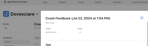

maybe is not the same.. but I got here searching a way..
  1. from Test Flight I DO see a crash:
  1. if I download I got
testflight_feedback.zip
  1. unzipping, I can see in in JSON:
{ "id" : "AILekJY1tZIOmVavWYVqgVE", "timestamp" : "2024-07-22T11:54:02.389Z[UTC]", "appAppleId" : 533461505, "cfBundleShortVersion" : "2.962", "cfBundleVersion" : "176", "deviceModel" : "iPhone11,8", "osVersion" : "16.3.1", "locale" : "it-YE", "carrier" : null, "timezone" : "Europe/Rome", "architecture" : "arm64e", "connectionStatus" : "MOBILE_DATA", "pairedAppleWatch" : "", "appUptimeMillis" : null, "availableDiskBytes" : 1258336256, "totalDiskBytes" : 63933894656, "networkType" : null, "batteryPercentage" : 39, "screenWidth" : 414, "screenHeight" : 896, "emailAddress" : ".......", "comment" : "Altro crash" }
  1. here is NOT a reread xcrah log..
any clue?
