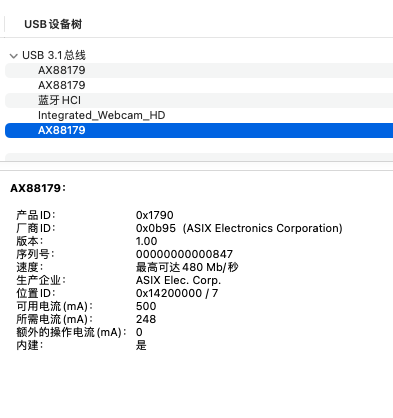

I can not activate AX88179 anymore after I have updated my mac to version 11.5 although On 11.4 Big Sur, everything was still be ok. I also check extensionsctl list on command prompt and it shows as follows:
mabook@mabooks-MBP ~ % systemextensionsctl list
2 extension(s)
--- com.apple.system_extension.driver_extension
enabled active teamID bundleID (version) name [state]
5RHFAZ9D4P com.asix.dext.usbdevice (1.2.0/1.2.0) com.asix.dext.usbdevice [terminating for uninstall but still running]
5RHFAZ9D4P com.asix.dext.usbdevice (1.2.0/1.2.0) com.asix.dext.usbdevice [activated waiting to upgrade on reboot]
How should I deal with this problem to connect to Ethernet

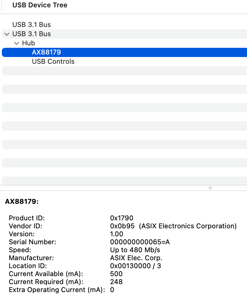

I have the same problem too. My current macOS version is 11.5.1. AX88179 network adapter is activated but not working, says cable disconnected. LEDs are off
* * 5RHFAZ9D4P com.asix.dext.usbdevice (1.2.0/1.2.0) com.asix.dext.usbdevice [activated enabled]
