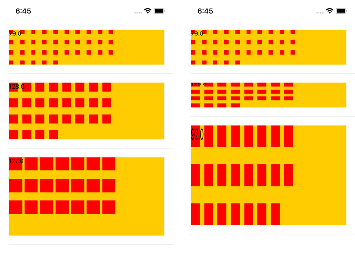

Problems:
Basicly the intrinsicSize works fine: When the TableView is rendered for the first time each row has a different height depending on its intrinsic content. However, the size is not correctly, since the intrinsicSize is calculated before the TableView actually layouts its subviews. Thus the RectsViews calculate their content size using the default width instead of there acutal, final width.
So: When/Where to calculate the initial layout?
Additionally updates to the properties (= tapping on the cells) are not handled correctly
So: When/Where to calculate the updated layout?
Again: Sorry for the long post and thank you very much if you have managed to read until here. I really appreciate that!
I you know any good source / tutorial / howto which explains all this, I happy about any link you can provide!
UPDATE: Some more observations
I have added some debug output to my RectsView and to a UILabel subclass to see how intrinsicContentSize is used.
In RectsView intrinsicContentSize is called only once before the bounds are set to their final size. Since at this point I not not know the final size yet, I can only calculate the intrinsic size based on the old, outdated width which leads to a wrong result.
In UIView however, intrinsicContentSize is called multiple times (why?) and in the last call, the result seems to be fitting the upcoming, final size. How can this size be known at this point?
RectsView willSet frame: (-120.0, -11.5, 240.0, 23.0)
RectsView didSet frame: (40.0, 11.0, 240.0, 23.0)
RectsView didSet rectSize: 10.0
RectsView didSet rectSpacing: 15.0
RectsView didSet rowSpacing: 20
RectsView didSet rectsCount: 35
RectsView get intrinsicContentSize: 79.0
RectsView willSet bounds: (0.0, 0.0, 240.0, 23.0)
RectsView didSet bounds: (0.0, 0.0, 350.0, 79.33333333333333)
RectsView layoutSubviews
MyLabel willSet frame: (-116.5, -9.5, 233.0, 19.0)
MyLabel didSet frame: (53.0, 13.0, 233.0, 19.0)
MyLabel willSet text: (53.0, 13.0, 233.0, 19.0)
MyLabel didSet text: (53.0, 13.0, 233.0, 19.0)
MyLabel get intrinsicContentSize: (65536.0, 20.333333333333332)
MyLabel get intrinsicContentSize: (675.0, 20.333333333333332)
MyLabel get intrinsicContentSize: (338.0, 40.666666666666664)
MyLabel willSet bounds: (0.0, 0.0, 233.0, 19.0)
MyLabel didSet bounds: (0.0, 0.0, 350.0, 41.0)
MyLabel layoutSubviews
When called for the first time UILabel returns a intrinsic width of 65536.0 is this some constant? I am only aware of UIView.noIntrinsicMetric = -1 which specifies, that the view does not have a instrinsic size in the given dimension.
Why, is intrinsicContentSize called multiple times on UILabel? I tried to return the same size (65536.0, 20.333333333333332) in RectsView but this does not make any difference, intrinsicContentSize is still only called once.
In the last call to intrinsicContentSize of UILabel the value (338.0, 40.666666666666664) is returend. It seems that UILabel know at this point, that it will be re-sized to a width of 350, but how?
Another oberservation is, that on both views intrinsicContentSize is NOT called after bounds.didSet. Thus there has to be a way to know the upcomming frame changes in intrinsicContentSize before bounds.didSet. How?

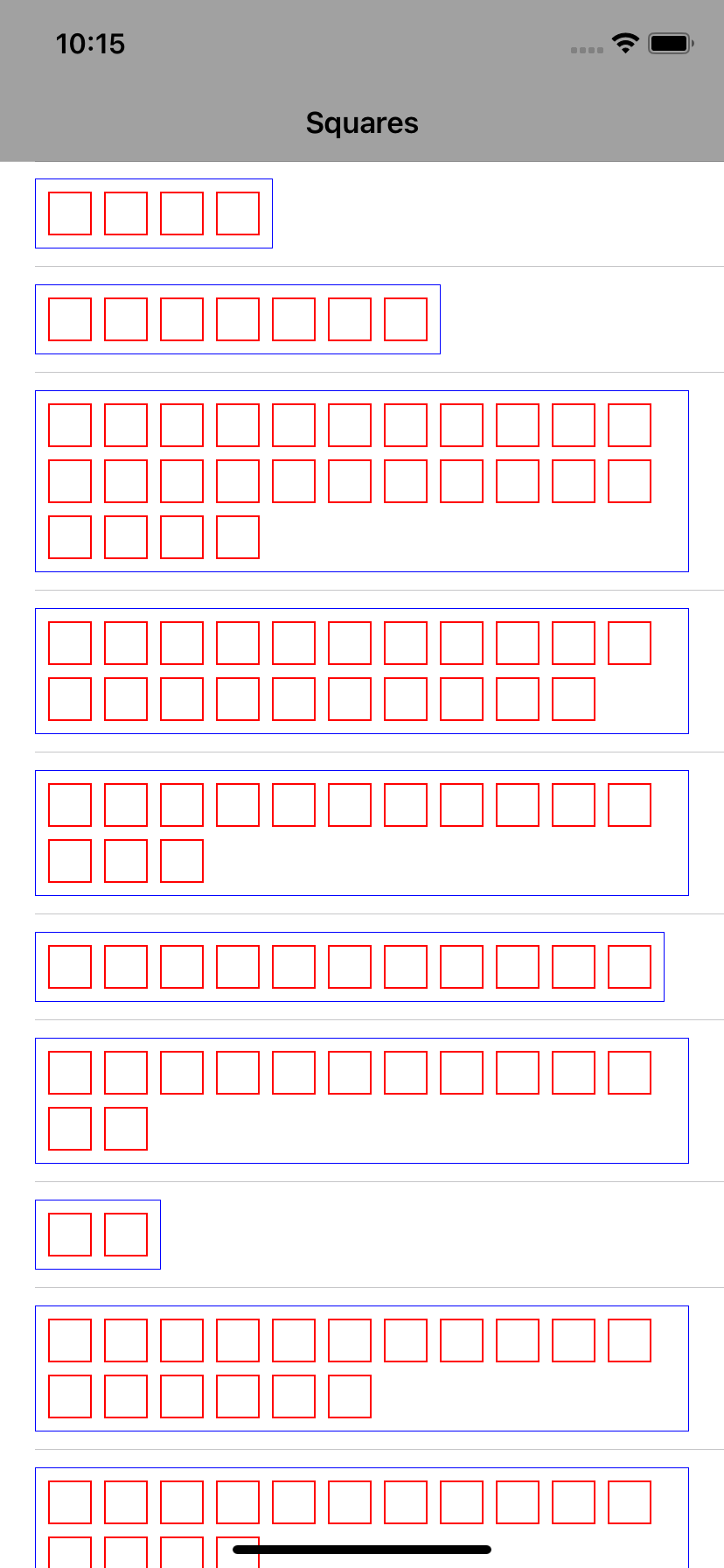

Full source code in GitHub
Step 1
In class SquareView : UIView the key is to define a "property called preferredMaxLayoutWidth, which specifies the maximum line width for calculating the intrinsic content size.
Since we usually don't know this value in advance, we need to take a two-step approach to get this right. First we let Auto Layout do its work, and then we use the resulting frame in the layout pass to update the preferred maximum width and trigger layout again."
override func layoutSubviews() {
    super.layoutSubviews()
    preferredMaxLayoutWidth = self.frame.size.width
    invalidateIntrinsicContentSize()
    setNeedsDisplay()
Step 2
Now that we have our preferredMaxLayoutWidth we can compute the intrinsicContentSize:
override var intrinsicContentSize: CGSize {
    let width = squareHeight * CGFloat(squares) + padding * CGFloat(squares) + padding
    if width < preferredMaxLayoutWidth {
        let height = squareHeight + padding + padding
        let size = CGSize(width: width, height: height)
        return size
    else {
        let vertSquares = ceil((width / preferredMaxLayoutWidth))
        let height = squareHeight * vertSquares + padding * vertSquares + padding
        let size = CGSize(width: preferredMaxLayoutWidth, height: height)
        return size
Step 3
In the class SquareCell: UITableViewCell we have to force the layout of all subviews, which updates self's intrinsic height, and thus height of a cell. The key thing is to call super at the end (NOT at the beginning)
override func systemLayoutSizeFitting(_ targetSize: CGSize, withHorizontalFittingPriority horizontalFittingPriority: UILayoutPriority, verticalFittingPriority: UILayoutPriority) -> CGSize {
    self.setNeedsLayout()
    self.layoutIfNeeded()
    return super.systemLayoutSizeFitting(targetSize, withHorizontalFittingPriority: horizontalFittingPriority, verticalFittingPriority: verticalFittingPriority)
Learn more: UITableViewCell with intrinsic height based on width
Step 4
In the class SquareViewController: UIViewController make sure to reload the table when the orientation changes to landscape:
override func willTransition(to newCollection: UITraitCollection, with coordinator: UIViewControllerTransitionCoordinator) {
    coordinator.animate(alongsideTransition: { (context) in
        guard let windowInterfaceOrientation = self.windowInterfaceOrientation else { return }
        if windowInterfaceOrientation.isLandscape {
            self.myTableView.reloadData()
This is it!
Now enjoy creating custom UIViews that auto adjust to your table view cells!
