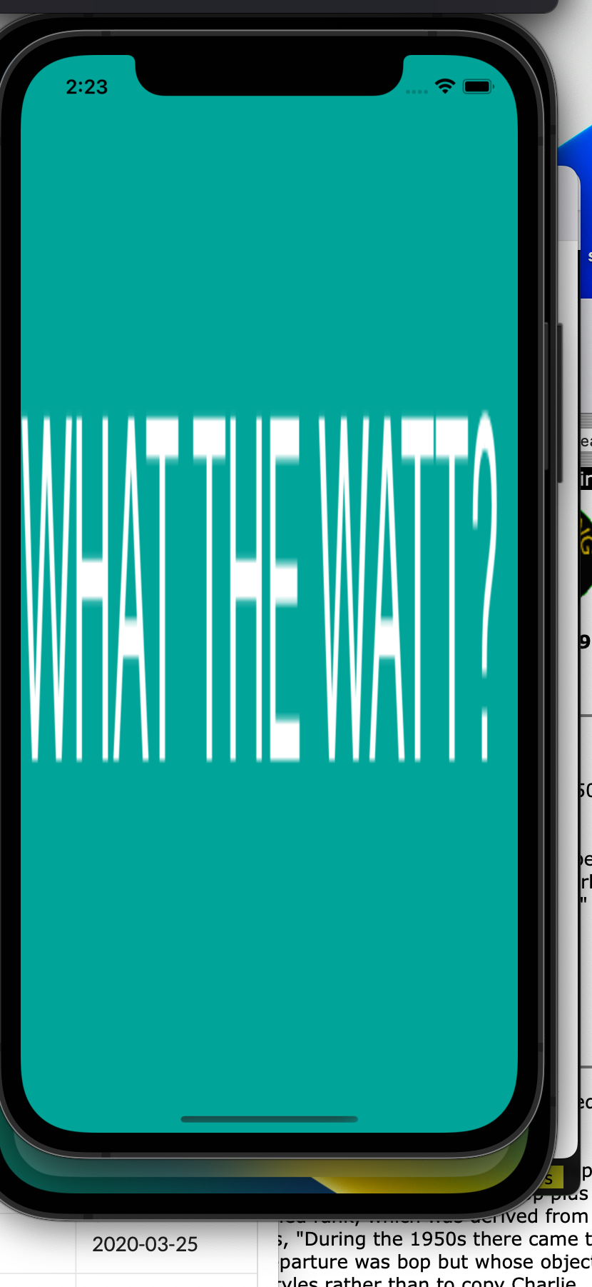

I am developing an app in swiftUI using Xcode 12.3, deployment target iOS 14.0. The launch screen is setup through info.plist by specifying 'background color' and 'image name'. The file used in 'image name' is from Assets catalog. (PNG format, size300 x 300 and corresponding @2x and @3x resolutions) What I have observed, when the app is installed for the first time the launch image is centered and have original resolutions but all subsequent launches show launch images stretched to cover full screen. Any ideas why this is happening and how to have more consistent behavior either way?
I have tried 'respect safe area' option but it does not make a difference.

Happens more often on simulator than device, but does reproduce occasionally on device
I'm having this same exact problem in Simulator, as well as physical device.

I hate to say this, but I believe this skewing happens if you only include one of the 1x.2x,3x and it does a really BAD, like bad bad, like no one cares job at resizing it by just stretching it to the available space.
I DO NOT want to add that extra 500K because that is 5% of my total app size budget for App Clip.
Even with 1x,2x,3x images it still skews. So, make it stop. Or not. I'm just here coding.
Same issue. Have tried nearly every hack out there. Nothing works. Image distorts. Refuse to use a storyboard. Apple has $100B+ in the bank. They can get on this.
